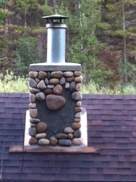

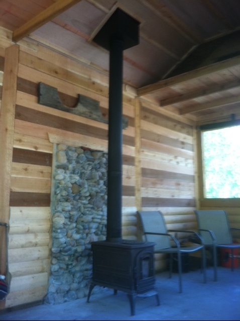

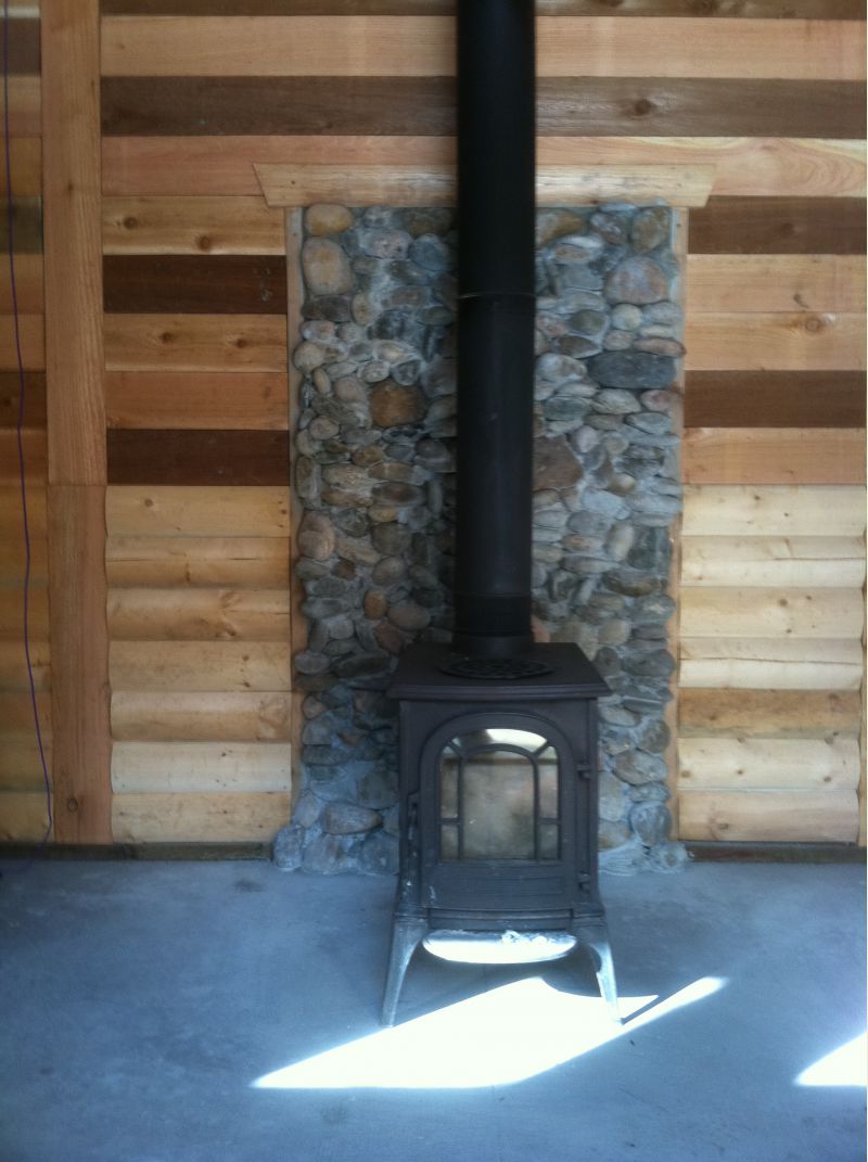

The folks at ventingpipe.com were really helpful answered all my questions and saved me some money as well --- give them a call and for safety's sake make sure you do this job correctly ..

Brokeneck, while looking at your pic labeled "rock", I got the impression your flashing is over the top of the shingles. Please tell me this is an illusion.
Tom
brokeneck
# Posted: 14 Nov 2012 04:53pm - Edited by: brokeneck
Illusion -- I was installing cultured stone on the chase -- this was just temporary 2x4s to keep the mortar off the roof -- and as you can see by the pictures I'm an amatuer at best and by no means do I usually know what I'm doing .. that's why i suggested the folks at ventingpipe.com : )

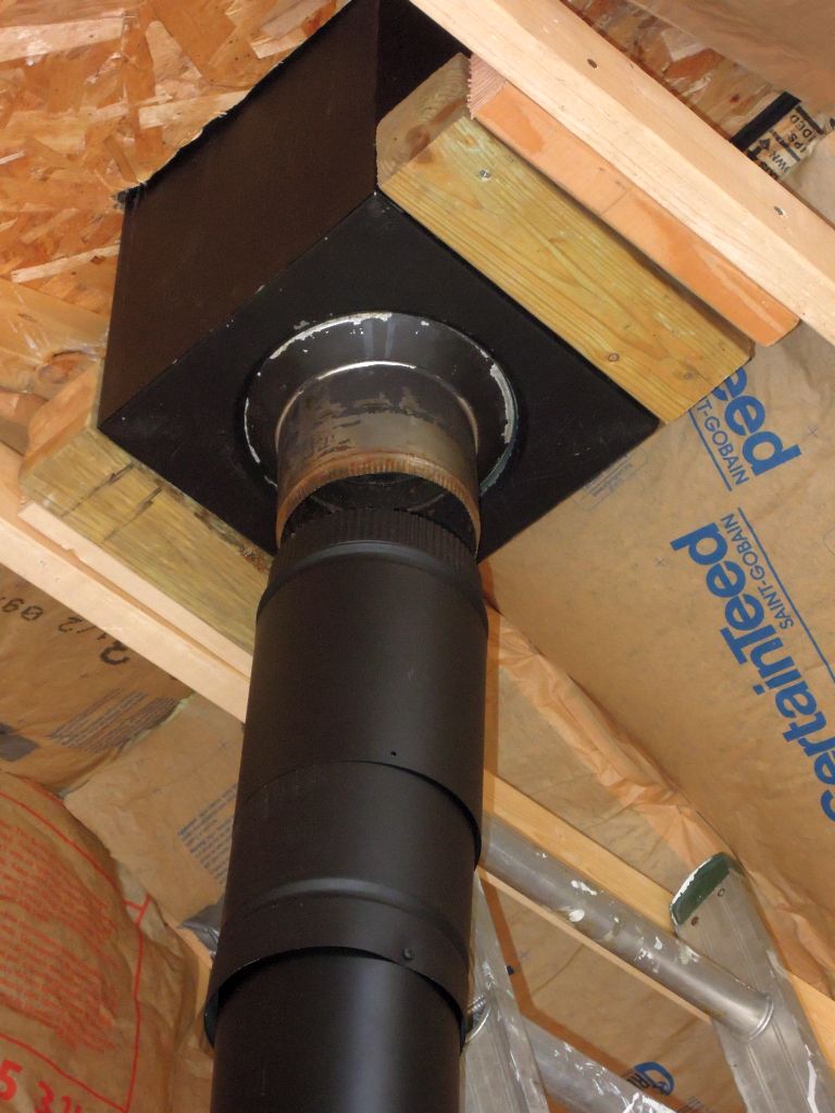

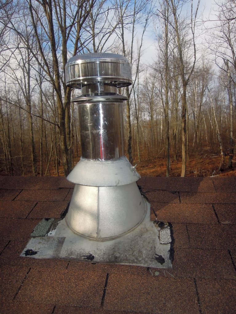

Dillio187
# Posted: 26 Nov 2012 09:55am - Edited by: Dillio187
I installed mine a couple weekends ago. The piece of stove pipe right before the box looks weird because it is an adjustable double-wall piece. Obviously it's not fully hooked up and secured with set screws in this picture, but you get the idea.
Yes, I did re-use the flashing, it came with the stove and saved me $50 as long as I didn't mind the bits of green shingle on it!
