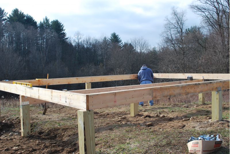

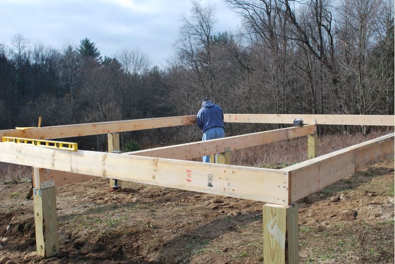

 Here are best photos I have of it.

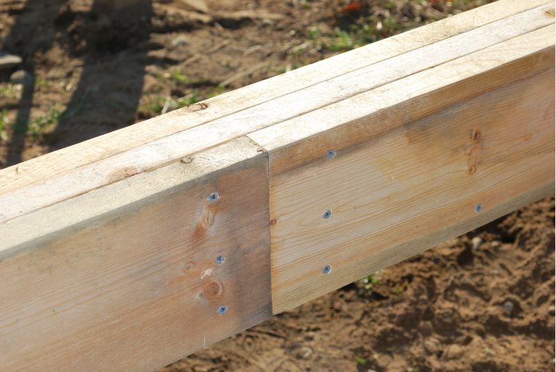

 |  Laminated center beam

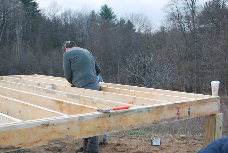

 |  joists
 |  joists
 |  joists

 Quoting: HopefulHomemaker Three 2x8x16s for the center beam (which the joists are sitting on top of) and two of the same for each side beam....
 Clarify this for me if you will. When you say "two of the same for each side" you mean two more beams like the center one (three 2x8's)? OR two laminated 2x's placed on top of the outside rows of piers?  ...  Looks like two layers in the outer beams in the images, but they appear deeper than 2x8... perhaps a trick of perspective??
 So my question is what are the outer beams? Size and number of layers?

 I think the way you have these is great.  24" isn't too much... Plus it gives you room to crawl around underneath.
 That looks well built to me!

 As for the original question... you need bracing. From each pier to the beam it supports as well as to a floor joist that crosses over the beam. That is bracing in the 20 foot direction down the long side and bracing across the 16 foot width. I'd suggest 2x6 material, carefully picked for the least number of knots and straightest grain, especially near the ends where the fasteners would be located.
 Braces would be diagonals, one end about two feet down the pier and the other end of the brace about 2 feet along the beam or joist from the pier. Set at 45 degree angle. Bolted through the brace member and the pier with a large washer under the bolt head and the nut at the other end. No carriage bolts.  One 1/2 inch diameter per brace end.. Do not over tighten; that is do not crush wood. Add five or six 16D nails; hot dipped galvanized.
 A better solution would be constructing what an engineer would call a shear wall. That is the spaces between the piers would be framed like a short wall with PT studs and a PT bottom and top plate. That would then be sheathed with 3/4 PT plywood on one side. The plywood would overlap the piers and the beam or joist. Nailed every 3 inches.
 I know the question was about pier height, but other things caught my eye. So, for what its worth here it is.
 The picture of the center beam showing an unsupported splice. A splice that is not directly supported by a pier is a bad splice. There is no nicer way to say it, it;s weak and potential trouble. It is also apparent that the beam slice is secured with a grey colored screw. They look much like the screws sold for use with pressure treated wood for securing deck boards, a surface to walk on. If that is correct those are not good as you used them. They are hardened and somewhat brittle, ideal for securing boards yopu walk on, but not for any structural use.
 A closer look at enlarged images leads me to believe that, yes, the two outer beams are also layers of 2x8's as the center beam and joists are. And it does appear that each outer beam consists of two layers. OK? If that is correct and the spacing between the piers under the beam is 10 feet, those beams are, IMO, woefully undersized.

 So, if my assumption that the two outer beams are built from two layers of 2x8 grade 2 common lumber is correct here's what my reference materials indicate. The piers should be no more than 5'4" apart if the snow load is 50 PSF; 4'9" if the snow load is 70 PSF. And all splices over a pier. That's assuming a lightly loaded loft is in the building design. Lightly loaded = no furniture to speak of.
 Or another way to look at it would be to use 3 - 2x12 or 4 - 2x10 for each beam with a post under each splice, for a 50 PSF snow load. For 70 PSF snow load, 4 - 2x12 per beam.

 It will have a loft, which is half over the porch.  The two out beams are two 2x8s.  We did not use deck screws, we used exterior screws.  We couldn't have had our splices over piers, because they all would have had to line up on the center piers, and that would have been even weaker than what we did.
 We really have no choice but to move forward.  We don't have the money or the manpower to tear down and rebuild from the ground up.  If we brace the piers as suggested, is this house going to be strong enough to live in?

 I noticed that the outside vertical sides of your posts are not in alignment with the outside vertical surfaces of your sills.
 When I build I ensure that these two surfaces are perfectly aligned.
 In this manner, when you attach the outside covering (Smart board?) it will present a perfect vertical surface from roof line to ground surface.

 To save having to re-build the center beam, why not just add supports to shorten the spans? It looks like your soil is easy digging.
 I'm not sure why you didn't use full length material for the beams, but a simple solution for stiffness would be to add a 2X12 to the perimeter. Just extend the notch down the post and nail/screw/bolt it on.
