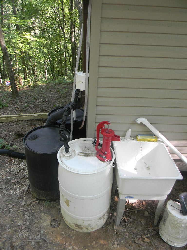

Low-tech non-electric pump version would be to use a pitcher pump, drinking water quality is available from Lowe's for ~$50 (US). Harbor Freight has a non-drinking water version for about half that. I have these affixed to the tops of my rain barrels, but one could run pipes to use one indoors. Freeze precautions apply if you run piping.
I have a 12 volt "barrel" pump with small diameter that can insert through the standard 55 gallon barrel opening. It is set up with tubing to a shower head, and electrically connect via switch to battery. We heat up a metal water tank and use this for a hot shower (keeps the wife coming back to the cabin)
I have a 12 volt "barrel" pump with small diameter that can insert through the standard 55 gallon barrel opening. It is set up with tubing to a shower head, and electrically connect via switch to battery. We heat up a metal water tank and use this for a hot shower (keeps the wife coming back to the cabin) Rain barrel with pitcher pump
