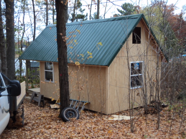

Seriously, I have built a lot with both. The new lifetime architectural shingles look good and seal very well and cost less than cheap tin. Metal is faster to put on, so I charge the same for either. I just look at twenty year old roofs and don't like the faded paint on the metal.

Martian, It just reversed of that here. Metal is $100 and Timberlines are $80.
Hey, it's all what you like.
Owen
metal
metal
same cabin with shingles
