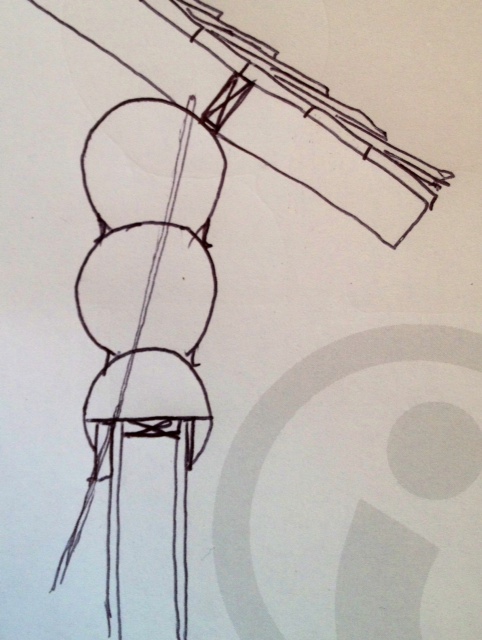

Anyone know a way to drill a VERTICAL hole down (or up) thru a stack of logs? I have about a foot below for the drillmotor going up OR about 8 inches above, (above wall, below the roof boards) to drill down. I could increase that a little using an angle drill.
I would like to drill through the entire 8 foot wall so I can hide a wire up to the loft. Drilling 4 feet would be OK too (for the light switches) Hole size can be small (1/4") I will be running wires for LED lights. Once I get to the middle log I can easily hide wires in the chinking to go horizontal. If I can't drill I may be able to hide small (LED sized) wires in the zigzag corner chinking.
- A method to drill larger 1/2" - 3/4" holes is interesting too then I can run a couple 12g trunk lines.
This sounds just about impossible but I thought I'd ask.

Theres a couple ways to do it that I know of, though mostly you need to plan ahead. I had 4' and 6' drill extensions made. I use auger bits, they are far superior to spade bits, as they clean the chips from the hole and dont need to be forced in to drill, they have a screw point to draw the bit in. I also discovered that a longer auger bit is best, as it doesnt clog up with chips like a short auger bit does when the bit is shorter than the log diameter. Having to pull the bit back to clear the chips is bad, especially when the extension comes off the bit down in the wall. I drill down through all my walls to run all-thread through them to tie the walls together near the corners, and for steel stabilizer pins next to windows and doors, and "X'ed" through the ridge and purlins. Planning your wiring while building helps, though with a little creativity, you can route wires 'round about and keep them fairly clean looking.
If I do it again, I may have auger bits welded to the extentions rather than fight with the tiny set screws that always tend to come loose.
You can chisel grooves into the corners to lay the wiring in (will look zig-zag going up the joint) then chink over it. That also works next to door frames etc. Just make a little wider chink joint. I try for narrow and deep with the wire in sideways. This may be more useful in your case, since you dont have room for long bits. Running the wire in a chink joint makes them invisible, but can add to the length of the run. Not a huge problem, but takes more wire to keep it clean looking. Always remember, make your wire a few feet longer than you think you need. It's cheaper to cut a couple feet off than re-run the whole wire and have an oddball left over. The leftovers can be used for pigtails anyway.

Have you considered removing one of your windows? You could then drill up and down with more space to work with and reduce the amount of logs you need to drill through. Then run the wire and reset the window. I have done this in the past.

I'm inclined to hide or avoid visible conduits, so this helps a lot. I'll come up behind the door casing on one wall and remove a window on the other wall. Looking at the window I'm inclined to try removing just one side of the windowcasing. Since it doesn't have to be vertical there may be enough access to drill thru 4 logs although it may get into the chinking. I don't have any insulation in there just backer rod. Then a little "chiseling & chinking" and I'm all set! Thanks!

Drilling 8 feet would have been an engineering (or internet) challenge.
But removing a couple windowcasing boards then drilling thru 3 logs, the project just got "easy". Yes the drill could bust out at the chinking. I'll bias it towards outside the house, and if it does bust out, I will insert the wire then hide the offense with chinking goop.
