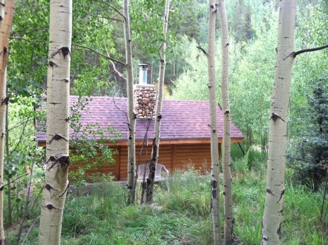

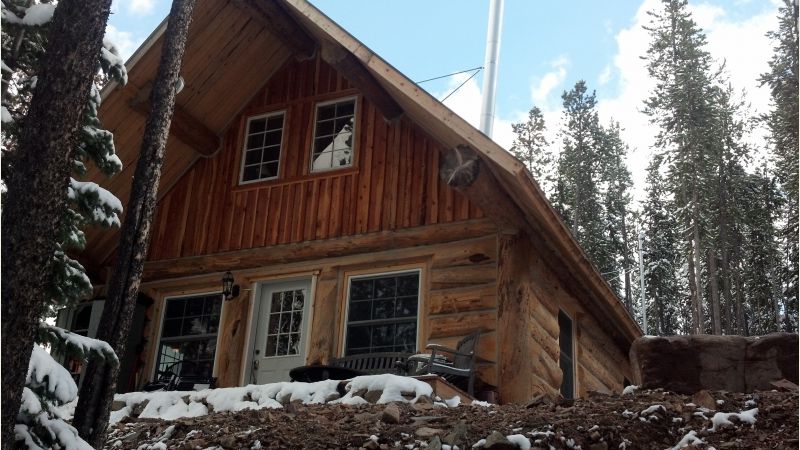

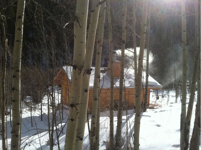

Another example of cedar used at corners .. I guess to some they will always look phony but short of real logs I like the look -- We actually used real 6 x 6 cedar uprights because we had them around and wanted to give it a pole barn look - but on the inside I had to face these verticals with 6" cedar fence pickets to make them a little more flush with the siding ... I think they still look quite genuine .. on the big house we also used fake logs --but those are actually steel siding ... ceiling1.JPG

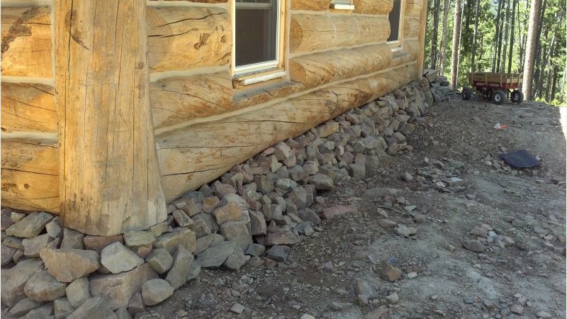

# Posted: 30 Nov 2012 07:36pm
Well, we have an actual log cabin that is finished with vertical logs at the corners (the shell was built at another location and each wall was trucked to our site.) If you like the look, you could probably fashion something similar to cover the corners of your log siding: Close up of corner
|  better shot of the look
brokeneck
# Posted: 30 Nov 2012 08:49pm
Montanan -- I'ts awesome how is supported?

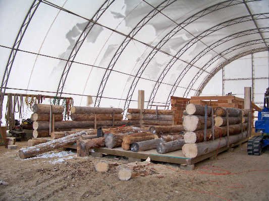

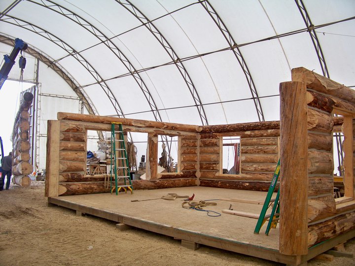

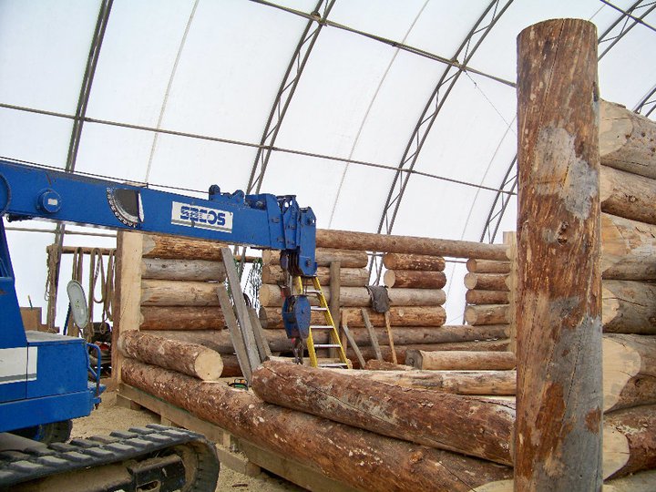

# Posted: 1 Dec 2012 11:20am

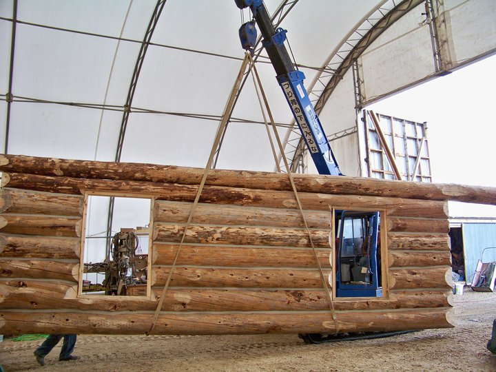

The front and back walls were built with the vertical logs bolted on and then the side walls were bolted to the vertical logs to complete the walls. The foundation is pier blocks. I'm so terrible at explaining this. Here are some photos that do a much better job of illustrating the design. The first 2 show the construction itself and the second 2 show dismantling at the shop for transportation and reassembly at our site. Early stages of log walls.
|  Flat sides of vertical logs for bolting the walls together.
|  Taking the walls apart for transportation.
|  Moving the walls to the truck for transport.

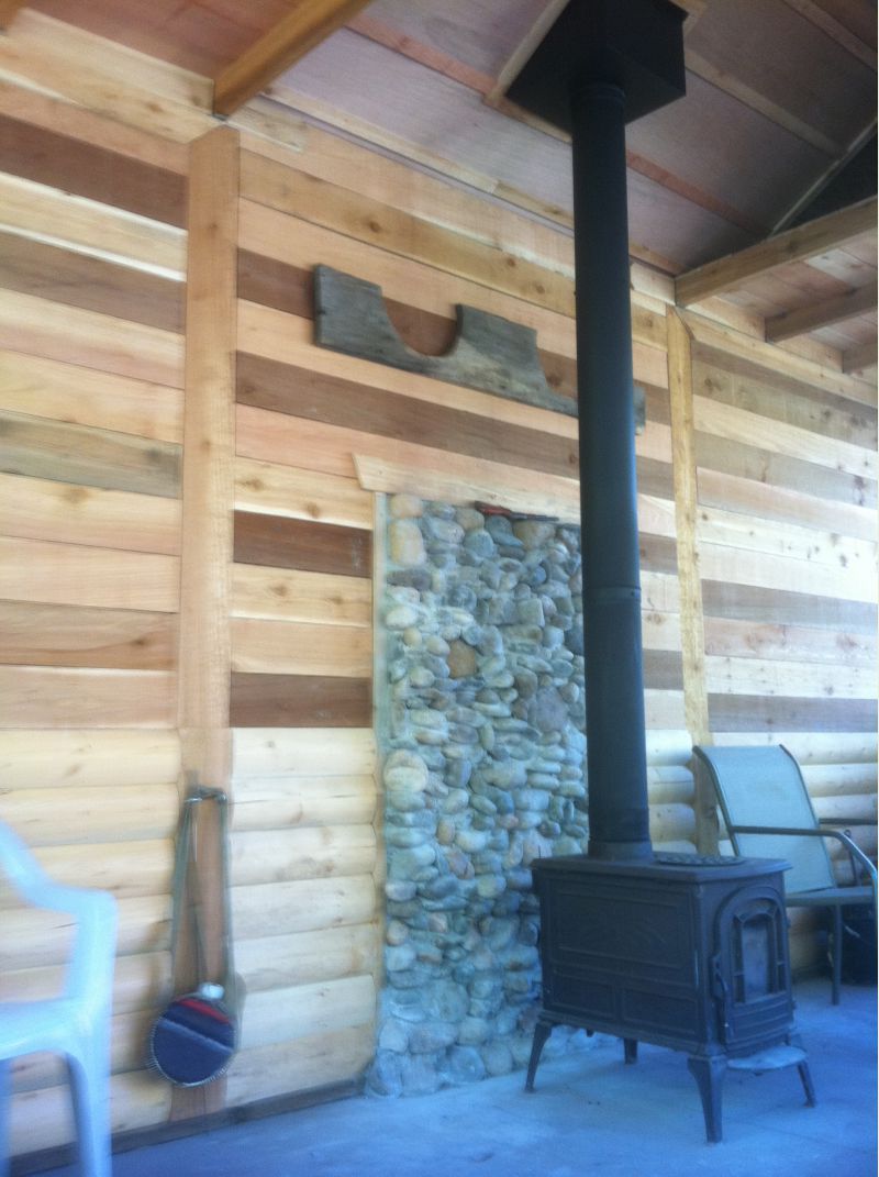

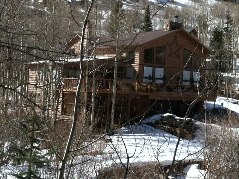

# Posted: 3 Dec 2012 09:55pm
The log siding on my little place is 1 1/2" thick. Ive built a couple houses with it, and the portable cabin in the pic, everyone seems to like it pretty well. I also use it inside some, it looks good inside as well. It looks just about like milled logs do, but cost less and is easier to do your wiring, plumbing etc with compared to log.
I think the larger log siding looks nicer, but you have to figure out whats available and fits your budget.
Log siding used inside a house,
and inside the portable,

Malamute
# Posted: 5 Dec 2012 12:18pm
Thanks.
The upper pic was the living room area of a 1200 sq ft house.
The portable is just that, small enough to be moved to a buyers site. It can be added on to also.
I also like a bit more space, but the small ones work for some people for part time or starter places, or if they are seriously into downsizing.

# Posted: 5 Dec 2012 09:05pm
Those were done with Messmers UV plus. It's the "natural" color. I dont use any finish inside other than floors, for health reasons, and I like the look of the naturally aged wood.
