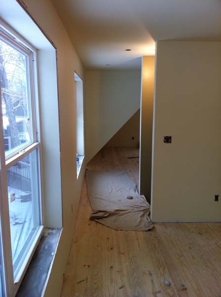

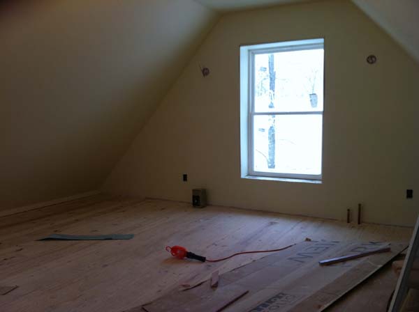

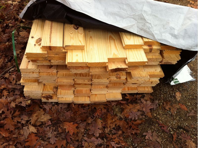

We did the same. It is exposed under as the ceiling and the floor above. We put a glue like product down to prevent squeeking and used a nail gun to the tongue. Went up in a day with 2 people -30'x18'. Boards delivered
|  loft before
|  loft after
|  after

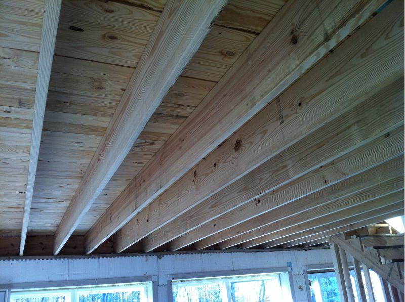

Here is a look from below. We were cafeful not to drop the glue or let it squeeze out.
