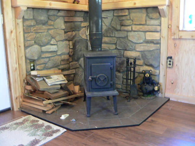

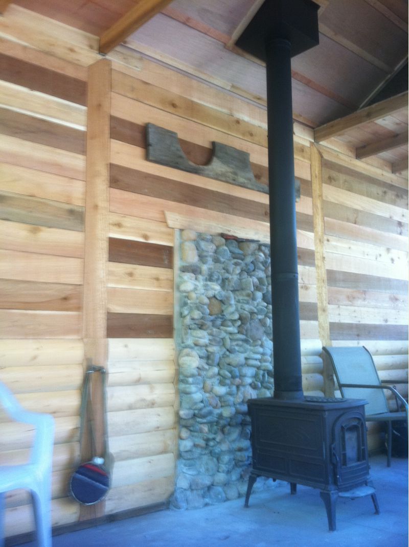

i have a simalar problem. if you look at the stove that insulated pipe is no longer there. that helped alot but as you can see the walls are not insulated . althought the stove is rated twice what i should have needed, without insulation we cant keep it warm (over 63f) in there. as it stands we dont use the cabin from jan 1 thru mar31. hope that helps.

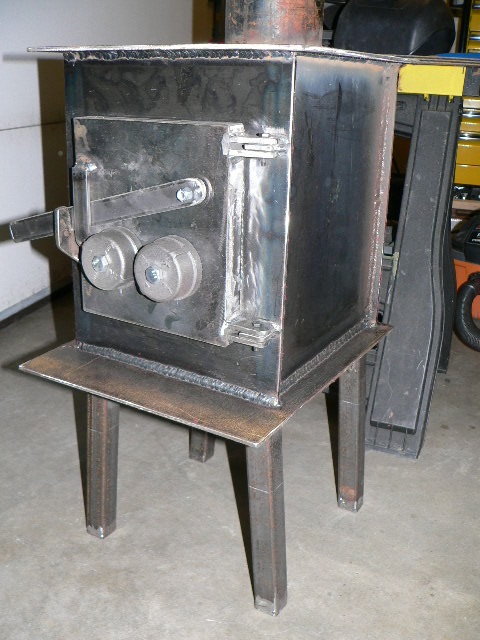

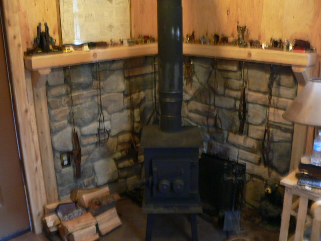

I have a smaller woodstove that warms my place up well, its fully insulated and sheated. But it take a while to heat up objects inside the cabin including walls. I call it thermal mass. Once its absorbed heat and at room temp, then it gets warm and the heat is more stable. Even after the stove goes out, room stays warm for many hours. The thermal mass returning absorbed heat. My stove is home brewed, its all 1/4" plate steel and its water tight (not just air tight) and for it and the firebrick to warm up even takes a bit.
during build
during build
Original Fjord stove, replaced...
Home built installed

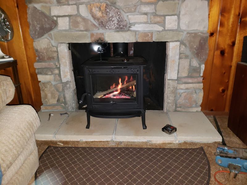

I just got my Jotul 100 installed in my 600 sq ft insulated cabin. I have a short 13 foot but wide masonry chimney so I went with an insulated liner. I found I need to heat up the stove with my ceramic heater to get the draft going but not a big deal. The stove heats up the entire place quickly. If fact I need to learn how to keep a smaller fire going. 80 degrees is very achievable. So far very happy with it.
