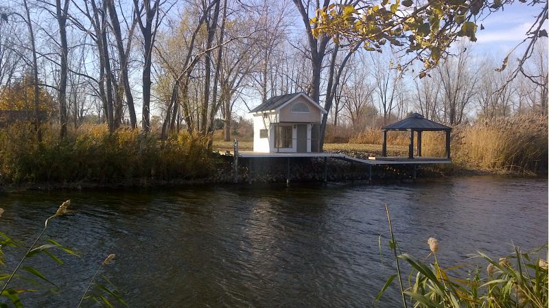

I must have been lucky! I wanted to stay within the rules of the 144 sqft....If I wanted to go bigger I had to have a house built to the Minimum sq ft requirement of 721 sqft! I just decided that it was cheaper to get a permit and build the minimum sqft. I paid $85 for the permit and scratched a plan on a napkin at the zoning office that they copied and put in my file....I cannot even remember anyone coming out to do an inspection because it still is not finished 15 yrs later! Maybe that is the key...to never finish so they have nothing to inspect!?? Suckers!! Looks like I beat the system! IMO
# Posted: 5 Dec 2012 08:46pm - Edited by: MtnDon
sometimes you just fall through the cracks....
