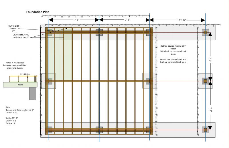

May or may not be of help but here is a jpeg of the design I used for my 16x16 (with 8 ft loft extension over deck) - basically a 16x24 from a foundation perspective. Couple of things to note - I used a poured footing all around with concrete piers as shown. Obviously more work and cost but it does tie in the piers together. Also, I was using a structural ridge beam so I needed to have 3 good paths down to the foundation along the center line, hence the extra rim/joists on both ends. Other ways to do this but this was just the easiest. With just two people building the cabin I often went for ease over cost. I put a 2 piece beam down the center - not to reduce the span (as MtnDon stated, the 2x10s are fine for the 16' span, but to make it easy to layout 4x8 PT across the beams and under the joists so I could insulate and close in the joists. It likely does reduce any bounce a bit but this was secondary.

That is a ton of help.
I like the idea of using 8 foot lumber with a center support because this will be a one or two man job. Easier is definitely better as I get older.

# Posted: 5 Dec 2012 01:59pm
Sorry to say but, although it may not be clear in the diagram (much clearer in the original Visio file) these are 16' pieces. Harder to lift but less connections or failure points!
