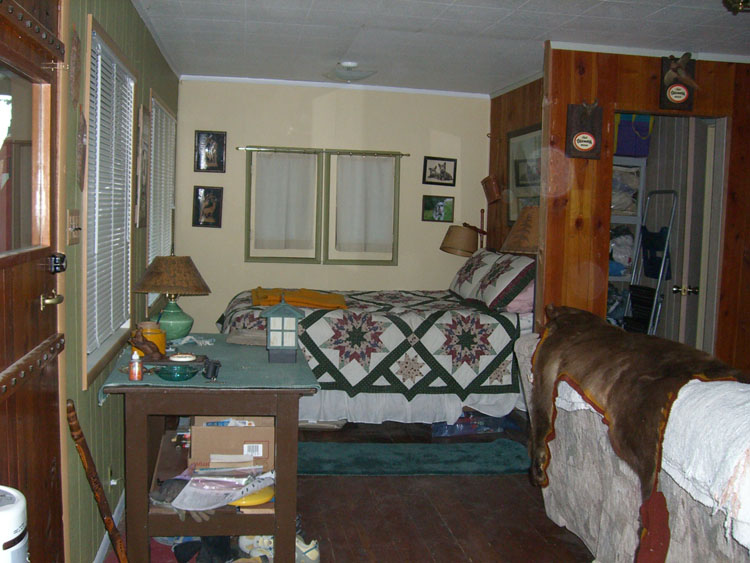

Just trying to update the look. The only utilities are wiring that could easily be rerouted if necessary. I'd say the height is about 5.5 feet from the false ceiling to the tallest point of the roof. The only thing above the drop ceiling is the insulation and the rafters. I don't have an interior photo, but you can see from this picture the rafters run from front to back. Disregard the covered porch, I'm thinking of the main body of the cabin.

So they are rafters for sure. I see snow so you want at least an R38 for full year usage. So if the cavity of your rafters are 9" or bigger you might be able to go fiberglass batts only. If they are 9" or smaller you might need to: 1. add new boards to make the depth more or 2. go hybird rigid foam and batts. So if you had 2x8"s you could go R24 or R30 in the between rafters and put a couple inches of rigid foam attached to the rafters and put drywall or t&g ceiling on that (with long screws of course).
Now to venting...
Was the drop ceiling added later or was it meant to be the ceiling? Meaning is the roof vented and is that entire 5.5 ft area open like an attic? If so that area is roughly the same temp as it is outside so that the roof can last longer. Which also means that along with stuffing the rafters with insulation you have to have a air channels from soffit to ridge vent.
Now if you have the money or know how you can rip everything out and use spray foam. If closed cell you wouldn't need to vent and you'd get your R value. My guess is that would be around $1500.
Now cosmetic...
If you take out the drop ceiling your are going to be left with more than just insulation and electric to tackle. You will have ceiling and two gable ends to refinish. You have probably thought about the ceiling since that is the reason you started this thread. However, have you thought about the gable walls. Will it need to be done in the same material as the walls. Will you have interior walls that will need to be extended? Will they need to be insulated as well? They could get a different treatment like you have on the outside and that would look nice.
Loft option...
- 5.5 ft area: could that be used as a sleep loft? thinking about the bedroom/bathroom. Keep their interwalls the same and make a loft above.

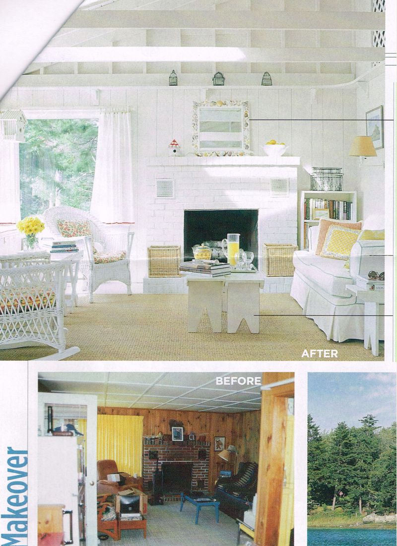

I pulled this photo from a magazine article. They had removed the drop ceiling. It appears tho, they do not have rafters nor did they insulate. But you get the idea of how much bigger the room seems

It makes sense after seeing the pictures.
Another insulation option is blown in, the depth of the ceiling joists doesnt matter with blown in insulation. You could also vent the gable ends, rather than the eaves, tho both would be good.
If you wanted to remove the ceiling, you could add on to the rafters to give more insulation space, or just cover with tongue and groove boards over the rafters. As cabin calls said, you'd need to provide an air space between the insulation and roof sheathing. The C (cathedral) type insualtion gives the stated R value, but is slightly shorter and gives an air space for ventilation. You'd need to provide a vent along the ridge, and at the eaves.
You could also do a faux scissor truss type arrangment. It gives more insulation and vent space, but still opens up the room.

here's another photo that gave me this idea. Granted I won't be painting things white, and but they have exposed rafters.

It isn't that tough to add a ridge vent, tho if you raise the ceiling, it adds a fair bit of space you have to heat before you feel it down at living space level. Some like fans to move the warm air down to you, but,...you still have a larger volume of space to heat, and, to me, moving air feels cool. I'd rather not have a fan going in the winter, just have warm air around me that isn't moving.
It could possibly feel cooler in the summer wth a higher ceiling, but with the current ceiling insulated, it may not help, and could be going backwards in feeling cool in the summer.
I agree about it feeling larger with higher ceilings. Everything comes with a trade off though.
