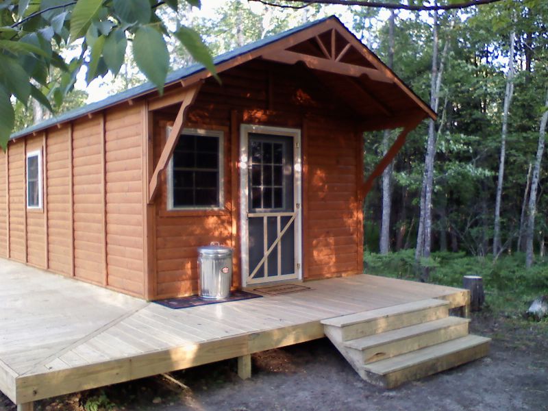

i saw your question under another topic. i didn't want to hi-jack that post so ill tell you what i think. the cabin is in north central Michigan and as far as keeping it warm its not hard to do. the problems come when the temps drop into the low teens and single digits. the cabin i bought is designed to be insulated but we never did. the assembly was fast, easy and simple. the entire project took 6 days from start to finish and require only simple tools and a basic knowledge of building squaring of a structure.

The deck is great. Did you build it as part of the deck foundation/flooring, or is it its own stand alone build?

if i were to do it all over i would have insulated the floor when i was framing it in. the deck does not share any structure but they are attached and were built at the same time. for me it was all about how long it would take to build. i didn't want to take years to build a log cabin, my kids were growing up fast and i wanted to enjoy the outdoors with them. panel concepts was very easy to deal with but if you want to save money purchase your roofing material elsewhere you could save up to 50%on that.

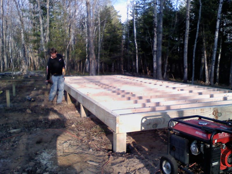

Thanks for the info and pics Larry. I just received my 20'x12' kit from panel concepts. If you had insulated the floor, how would you recommend doing it? Fiberglass insulation or rigid foam? How would you 'hold' the insulation between the joists and prevent small animals from getting into it? In your pics, it looks like you didn't back fill the post holes until you were finished with the decking/foundation. Any reason for this?

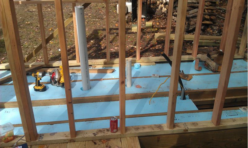

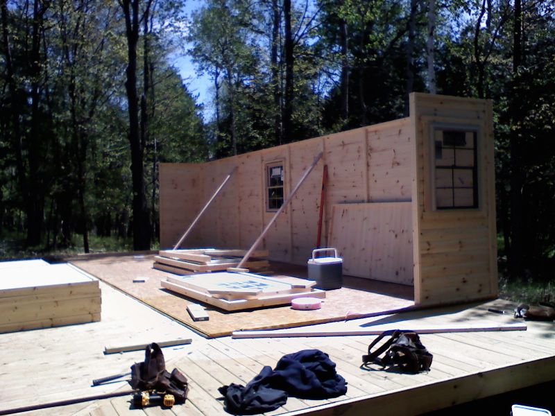

i used foam on the bathroom because if was free. the cabin will get fiberglass covered with chicken wire to keep critters out. my budy was building while i was back filling posts..it sucks so i was in no hurry. building tips; when all walls are up use a board screwed to the top to keep them at 144" apart while installing the roof panels. move the board as you go.when setting the interior beams use a string front to rear to help keep the beams level. where are you building?

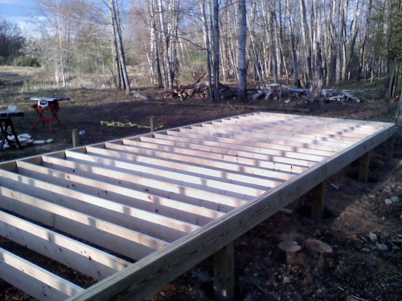

Could you describe your foundation/floor construction? I see the double rim joists. Are they 2x10's? Did you use joist hangers? Did you screw or nail them together? How did you attach the joists to the posts?

the lumber is 2x10 with joist hangers. i used the galvanized nails from simpson. the rim is screwed to the post and i added rafter ties for piece of mind.
