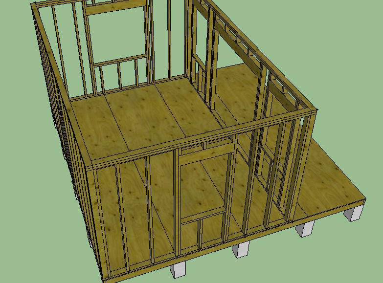

often too many people put too small of windows into their buildings. If i were you, I would lay out a simple drawing on some grid paper, using each grid as a foot (or whatever dimension you choose) and then draw in what size windows you think look good. Simply after doing that, determine the dimension size by counting the squares and see what the home centers have in relation to what youre looking for.
If you want to go a more complicated route when designing it, download "google sketchup". Ive designed my entire cabin on it down to the exact inch.

ArkansasCabin
# Posted: 12 Dec 2012 09:28pm
Reply Quote
pictures from my sketchup design
hakalugi
# Posted: 12 Dec 2012 11:28pm
Reply Quote
hey ArkansasCabin,
have you uploaded your files 3D-warehouse?

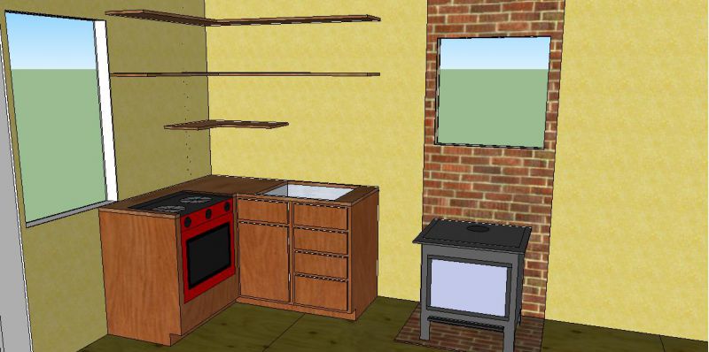

ArkansasCabin
# Posted: 13 Dec 2012 12:24am
Reply Quote
Hakalugi, no i havent uploaded my files yet. I was planning on doing that when my cabin was entirely finished (both the rendering on sketchup, and the actual construction of it)
Why do you ask?
*currently i'm working on the interior rendering. Heres a quick shot of it.
