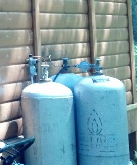

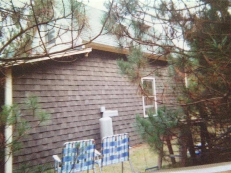

Sustainusfarm
# Posted: 13 Dec 2012 07:26pm
I have 2 100lb tanks delivered every 3 yrs....they bring the truck in the driveway then unload each tank onto a dolly...super easy and then they take the empty ones away! No fuss no muss!
Only have one 100lb tank in this pic.
