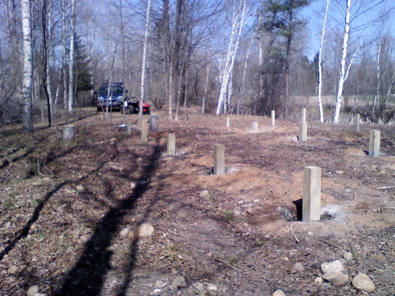

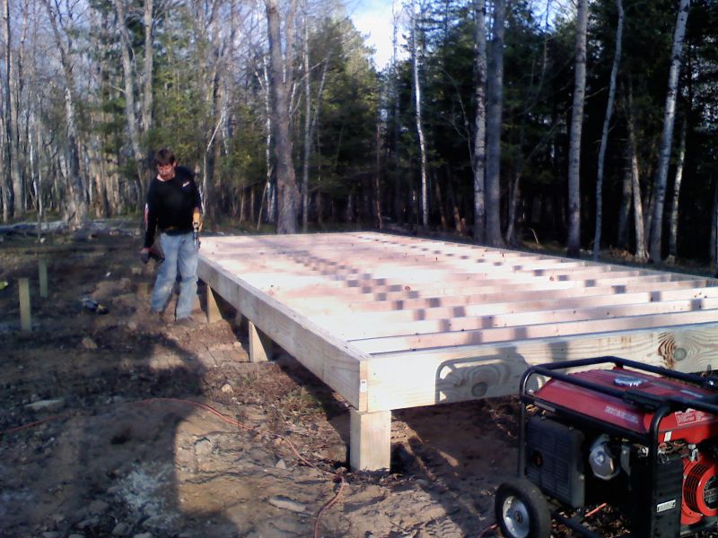

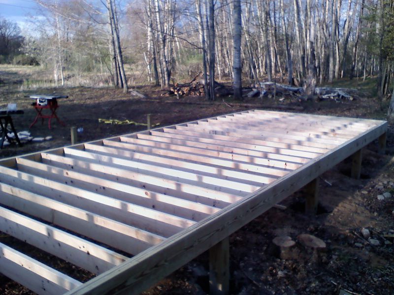

i used 6x6s every eight feet down the sides at a depth of 36". the width is 12' . i used a hydraulic auger on a cantilever due to the rock i had to deal with. i rented that from home depot.

Thanks for the pics and advice everyone! Maybe I will go the route of the post hole digger and just plan to back-fill my holes to get the correct diameter once I hit my target depth. I'm not afraid of a little manual labor
