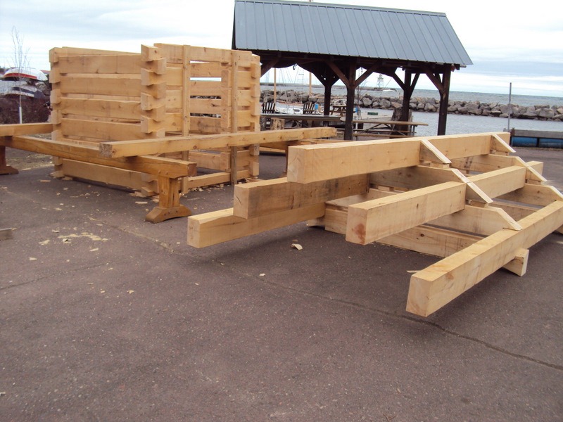

  In regards to building there are many options for building.  Here is some basic info:
  http://peelinglogs.blogspot.com/2011/.../log-cabin-building-information.html
  http://peelinglogs.blogspot.com/2011/02/liability-release.html
  As Tom Chum indicated, I, too, am not a fan of butt and pass (either round log or beam).  As I think hand-scribing takes patience and skill.   Butt and pass is pretty much stack and stake...no challenge or craftsmanship needed for that.  But it is quick and it is quite easy to figure out how to put a building together with this technique.  Stack and stake your logs (round or square), then back and chink the spaces.
  If you like the beam look, try dovetail and chink the gaps. Takes some basic skill (but it is very easy to learn).   Here is a post on how to layout a dovetail.
  http://peelinglogs.blogspot.com/2011/06/12-dovetail-layout.html
  Once you get the feel for the layout and practice cutting a few joints, you will find it only takes, maybe 10 minutes per joint.  You can put a building up quick.
  Timber framing is another option, I like the look of a frame from the inside. And I really enjoy framing; you can make quite complex structures with simple hand tools.
  In the end, I believe in hand-scribed cabins (My Swedish backgound); however, you better have some time to go this route.  When I built my log cabin, on a good long summer day, if I had two logs ready to peel in the morning, by days end I was happy if i got both logs on the building.  Of course you look at it today and every log fits perfect and there is no space between them.
  As exsailor indicated some of the techniques (timber framing, hand scribed) lend themselves to taking some type of class to make learning easier. Others...not so much. If you have basic mechanical skills ...with a little thinking and reading you can put together a butt and pass or dovetail building...you wouldn't need a class.

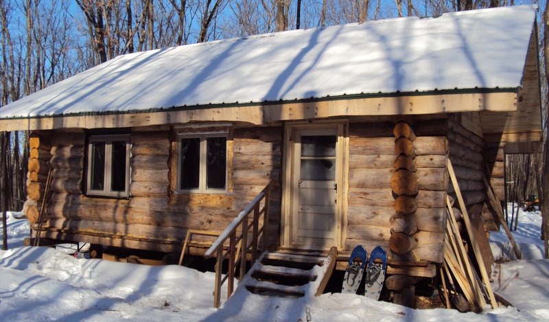

littlesalmon4
# Posted: 20 Dec 2012 03:51pm - Edited by: littlesalmon4

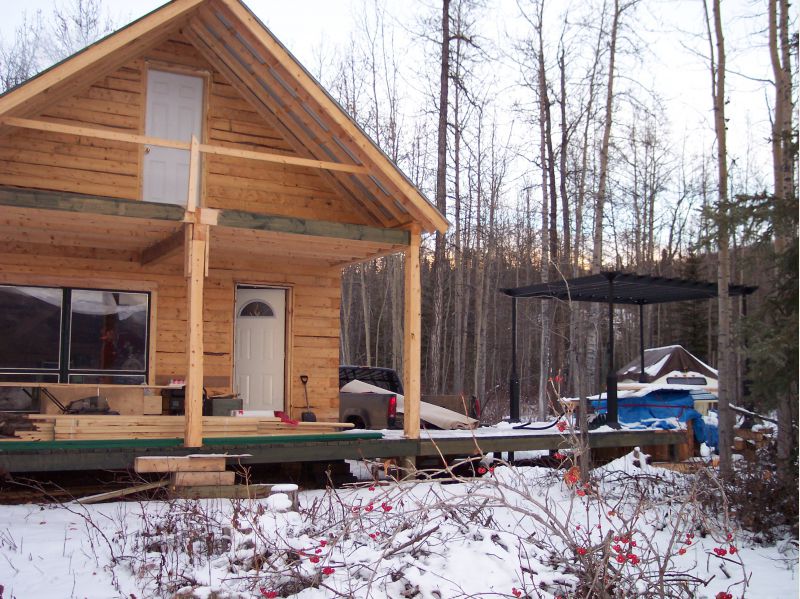

  We used rough cut 6"x6" with sill plate foam between them. Cabin has been up for about 5 years with no issues. We used expanding foam in the butt joins and 12" spikes every 2'  07_L_S_and_sled_pics.jpg

Tom W
# Posted: 20 Dec 2012 04:33pm
  Thats what I was originally looking at doing, looks good.
  Anyone see issues with using some solid beams to frame the doors and windows like post and beam construction?
  I was thinking the shrinking would cause gaps as the whole wall would not be able to settle as the verticals around the doors and windows would stop the top half of the cain from settling down.

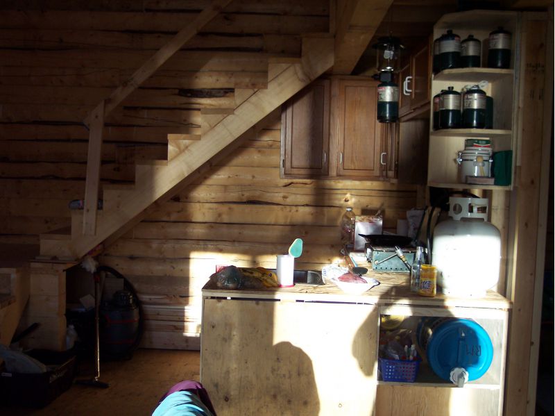

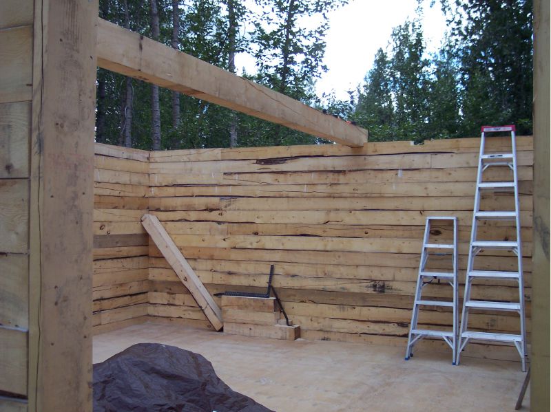

  I have built two cabins using this method, I used 6"x8" red pine timbers.  I used construction adhesive and timber screws to join them together.  Here is a pic of my first one  Cabin_Front.jpg

  Josh, looks good.  Hows it holding up?  Any settling?
  All great info guys, I think I am going to go with the butt and pass with the 8x8s predrilled and pound rebar every 4-6 feet.  I like the idea of the DIY laminated logs but I like the solid beam better.  Like was said in a earlier post I may use sill gasket on all the rows, and with the edges chamfered I will chink this grove as well.

  Just sold it this spring.  Built it about 6 years ago.  No settling.  I beveled the edges and chinked that groove, same as you are talking about.  I never thought about using sill foam, sounds like a good idea.   But I wanted to glue them in addition to screws so it would hold together better.  Maybe a strip of 3" sill foam with a bead of glue on each side would be optimal.

  Most of my rows are so tight you can not see the sill plate foam. There are no air leaks, the cabin is toasty at -45C. There should be very little settling if you use seasoned dry beams. I left about 2" over my doors and windows to allow for shrinkage. If I did it again using the same lumber provider I would only leave 1" of clearance

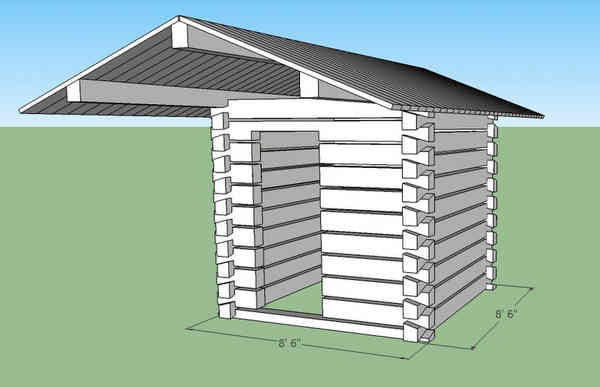

  I have thought of a different idea for log home corners. How about a huge log in each corner, standing on end, larger than the logs in the wall (even twice as alrge). Fill in between with logs jsut laying on end, pinned along the way with holes and rebar.  Then drill through the large corner log and lag the wall logs to the corner log.  Do this for each long. I think you would have to stager the logs on the corner so the lag bolts dont cross on each other.  one will can be a half log) The bolt heads can be setting into a counter bore with a nice round plug to close it off. Advantage would be the ability to replace a log in a wall etc or easy to add on and keep the look the same, ie add a butt out etc.
  Anyone have opinions on this? Don, bldg insp etc? Give me your thoughts.
  This would make construction fast.
# Posted: 31 Jan 2014 08:27pm
 Quoting: toyota_mdt_tech opinions  not sure but I think the corners would shrink less  than other logs leaving cracks in your chinking. wood shrinks less along it's length than it does across it's width.. IMO.ONLY, NOT SURE.
# Posted: 31 Jan 2014 09:35pm
  I have seen them built like this. I was wondering about that and another idea that crossed my mind was maybe the wood at the ends of the logs rotted away, and they just cut the notched log ends off and added the larger corner and lagged them in place. In that case, they'd already of shrunk.
# Posted: 31 Jan 2014 10:57pm
