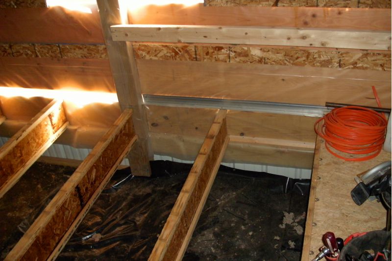

Here is a close up of my cabin design.I set 4x6 P.T. posts into the ground on concrette footers.42 inches deep.(frost line for here)The first corse of 2x12's and all other wood below this level is P.T.As you can see I laid out 6 mill plastic on the dirt underneeth sealling it up tight.Keep's the moister trapped under the vaper barrier.It's bassicly a pole barn design.
