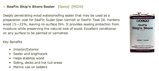

TomChum
# Posted: 20 Dec 2012 10:31pm - Edited by: TomChum
Wow, I dont want to do anything every 2 years (maybe just re-coat). I thought that was a benefit of an oil; not to put a hard finish on. Yes it makes sense that if the light is blocked then it can't degrade the finish. But wood color looks nice, i think is worth some level of effort to get it while I can. I guess I could paint later.
I have heard of Sikkens. They have some of it at HomeDepot, will take a look tonite.
Seems like marine finished would be about the toughest. Does anyone have experience with marine finished, and how long they last?

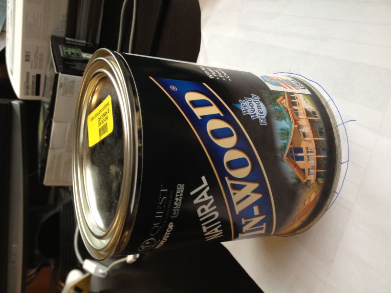

I settled on a product called "inwood, which is like a stain but it's a sealer. It's oil-based, ONE coat application. You put it on, and wherever it accepts more, you keep adding until it will take no more. They say it's same stuff as Sikkens but cost less.
When water no longer beads off (after 2-5 years), that means it is ready to accept more "In-Wood" so you re-apply, and wipe off the areas that it does not soak in. But it does NOT flake off, ever.

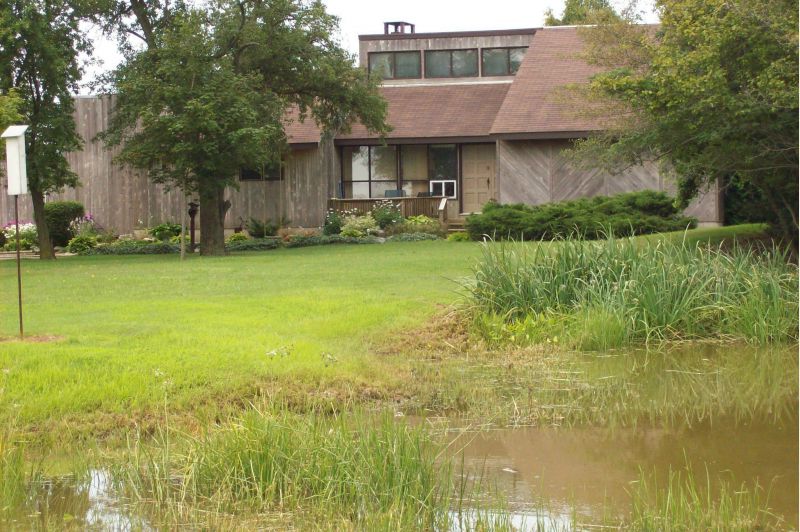

# Posted: 21 Dec 2012 10:18pm
I WOULD NOT DO THE SPAR THING .I tryed that when we built our ceder home years ago. the plan called for double door front entrance. wanting to preserve the new ceder doors i dressed them all up in the best spar i could buy .in two years i had to strip them and do them again . not wanting a 3 day job every other year,, they are now tope , solid stain..

# Posted: 25 Dec 2012 03:22pm - Edited by: TomChum
Quoting: Martian
Oils don't last as long, but are easy to redo.
Yes Martian, thanks for the 25 year answer. This seems like the way to go. I used In-Wood, one coat, and it was easy. Rubbed it with a rag after 48 hours, its smooth and shiny, looks great!
In-Wood oil stain finish
Stained fir veneer door, water beading.
Martian
# Posted: 25 Dec 2012 03:46pm
That looks good.

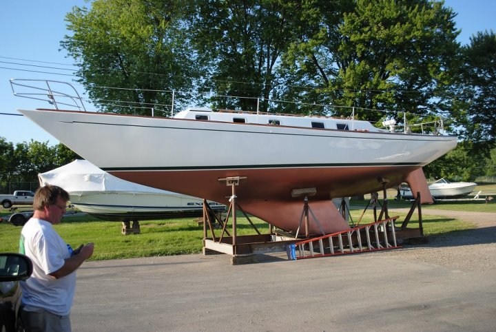

# Posted: 25 Dec 2012 10:25pm
Quoting: MtnDon
Interlux Perfection two-part varnish
that is the stuff!!! used on boats the stuff is all but bullet proof. i live near the big lakes and if you want it sealed for good that is what is used in these parts.
