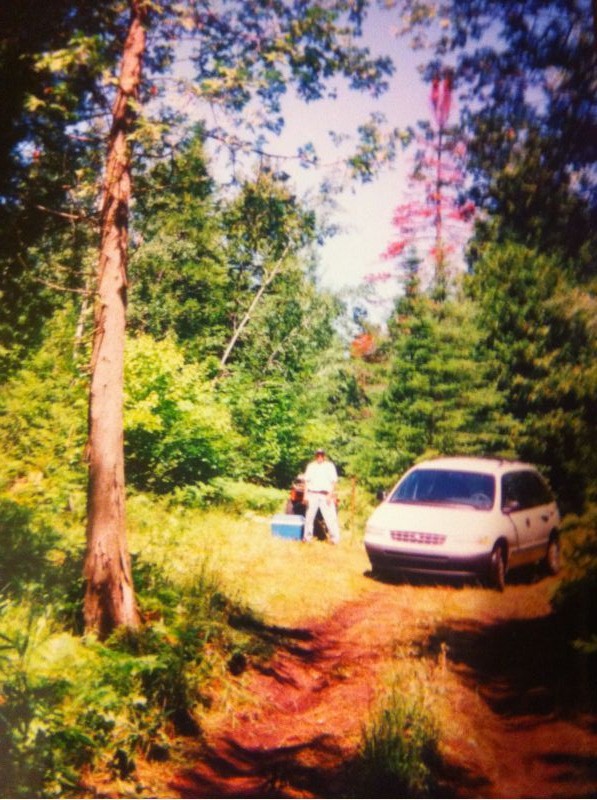

got any pics of your road ?
# Posted: 28 Dec 2012 08:39pm - Edited by: silverwaterlady
Here is one from me. It's part of the old logging road. This is before the road was finished and the cabin was built(we camped on site for 25 years before we could afford to build)we had to take our BIL's ATV the rest of the way,about one mile or a boat from the dock. My husband is standing in the spot where our road was continued. I don't have any other photos with me.
