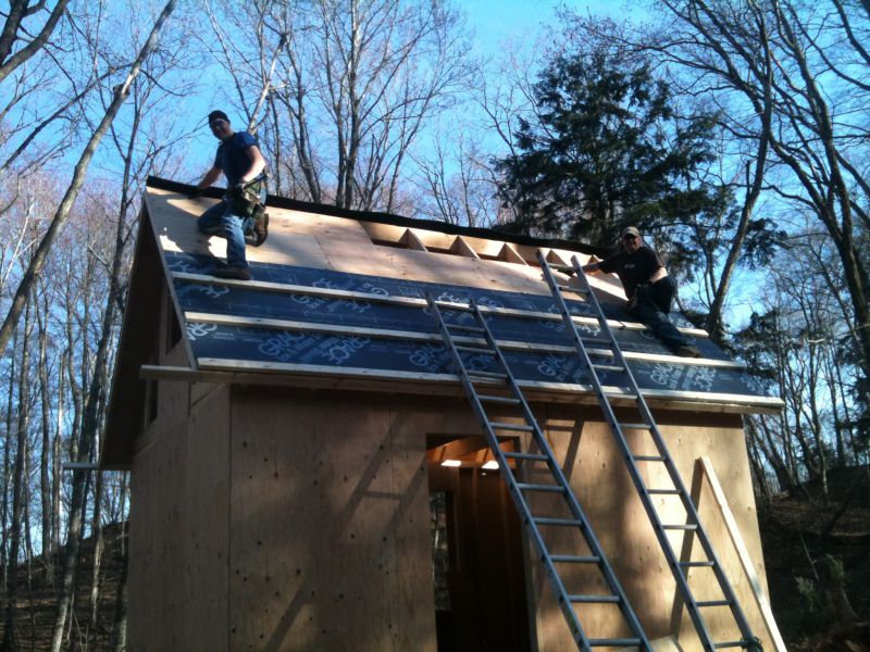

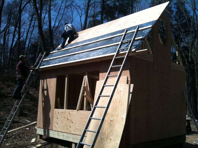

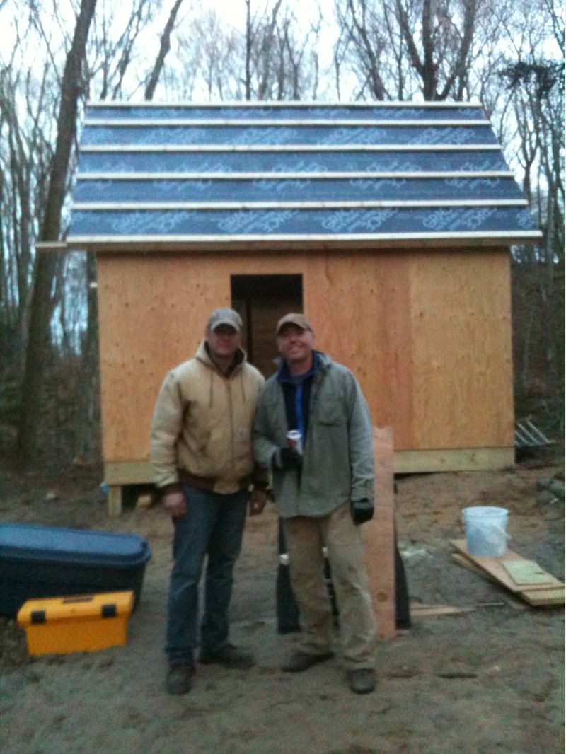

Here's what I did on mine...
rafters 2' on center
1/2 sheeting w/gap at the top for a ridge vent
ice and water shield over all sheeting
2x4 "furring" strips every 2' running horizontally
metal drilled to 2x4 furring strips
(see pictures)
then,
soffet vents
baffles on the inside
insulation on the inside
my friend did his this way...
1/2 sheeting
2x4 furring strips running horizontally
1' foil-backed foam in between furring strips
metal drilled to strips
not saying either was the "right" way, but neither of us are having any problems.
