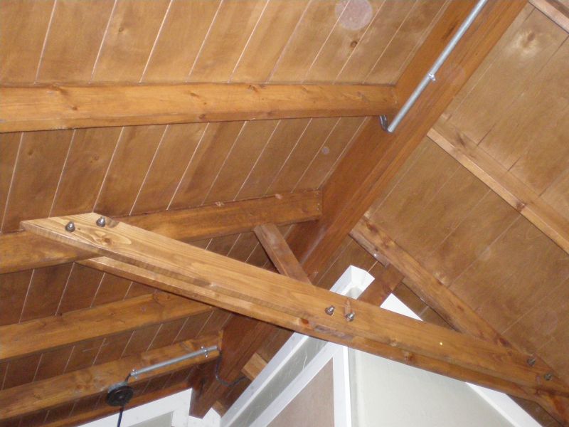

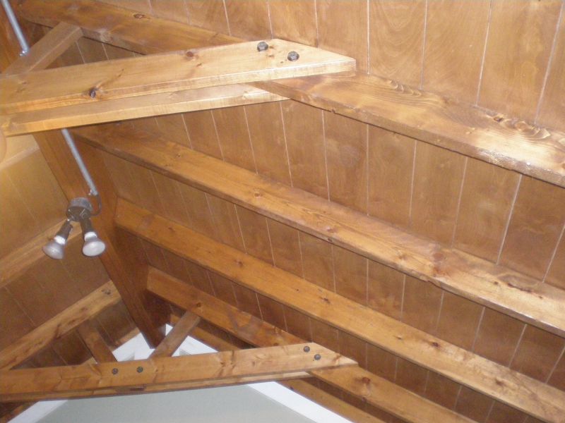

MJW
# Posted: 10 Jan 2013 08:35pm
Went to a propane place last week to get a bottle filled for the RV and the inside of this guys building/office gave me an idea for how I want to finish our place.
Directly on top of the rafters, this guy had taken cabinet grade plywood and had a cabinet shop mill it to give it the look of 1 x 6s. He then installed it directly on top of the rafters, added a layer of 2 inch foam insulation topped by OSB then felt and the roof metal.
The inside plywood and rafters were sprayed with a poly/stain and they looked fantastic.
I took a ton of pictures (which unfortunately my wife is visiting her parents and I don't have the camera to show you) and I think we are going to do this exact thing.

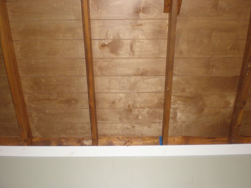

# Posted: 11 Jan 2013 08:00pm
Here are a few of the pictures of that ceiling I referenced earlier. P1070001.JPG
