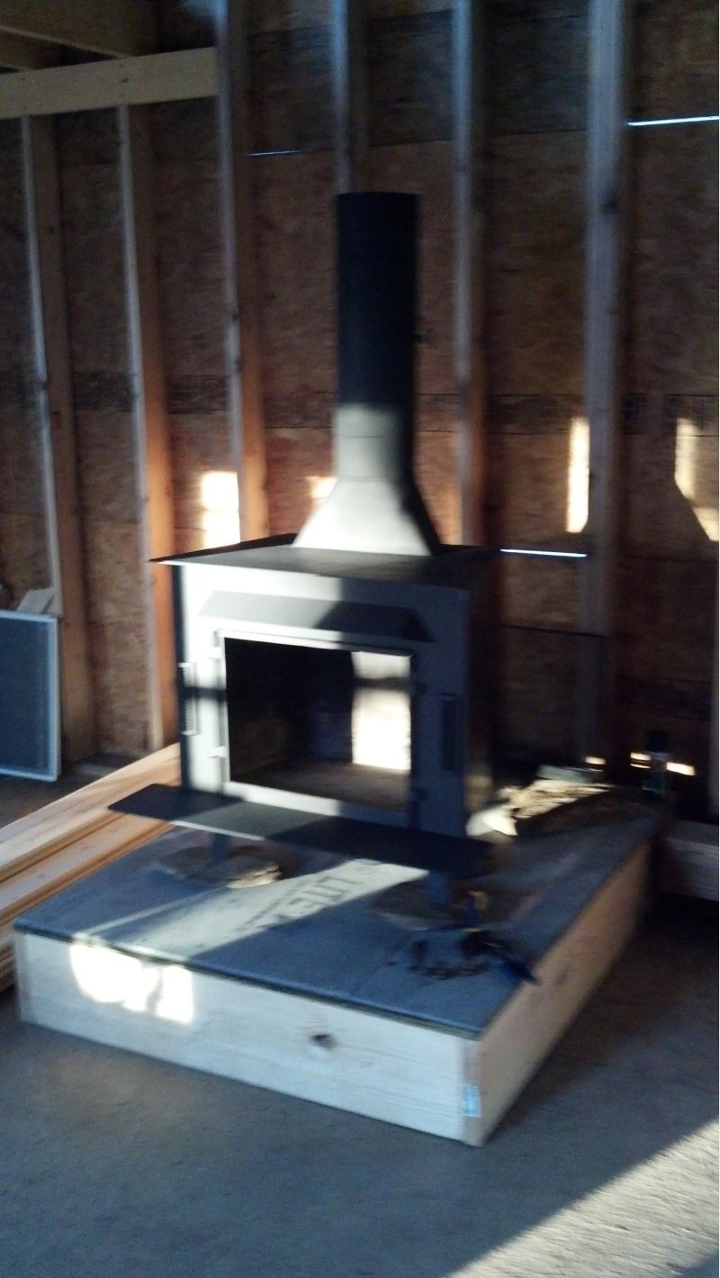

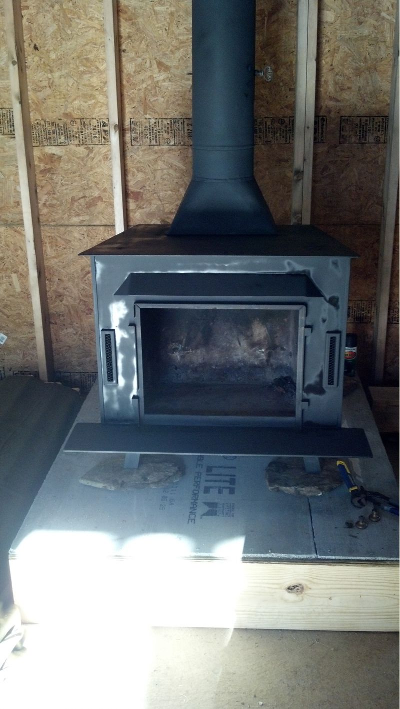

SonnyB
# Posted: 24 Jan 2013 10:57am
Thanks for all the info! I have an old stove that I built the hearth and set the stove in place. I am going to look at Tractor Supply since there is a new one near me. I have been checking on line and found the pipe for around $750 for all of it.
Anyone ever use one of those silicone red boots that are rated for wood stoves? 20130119_wood_stov.jpg
