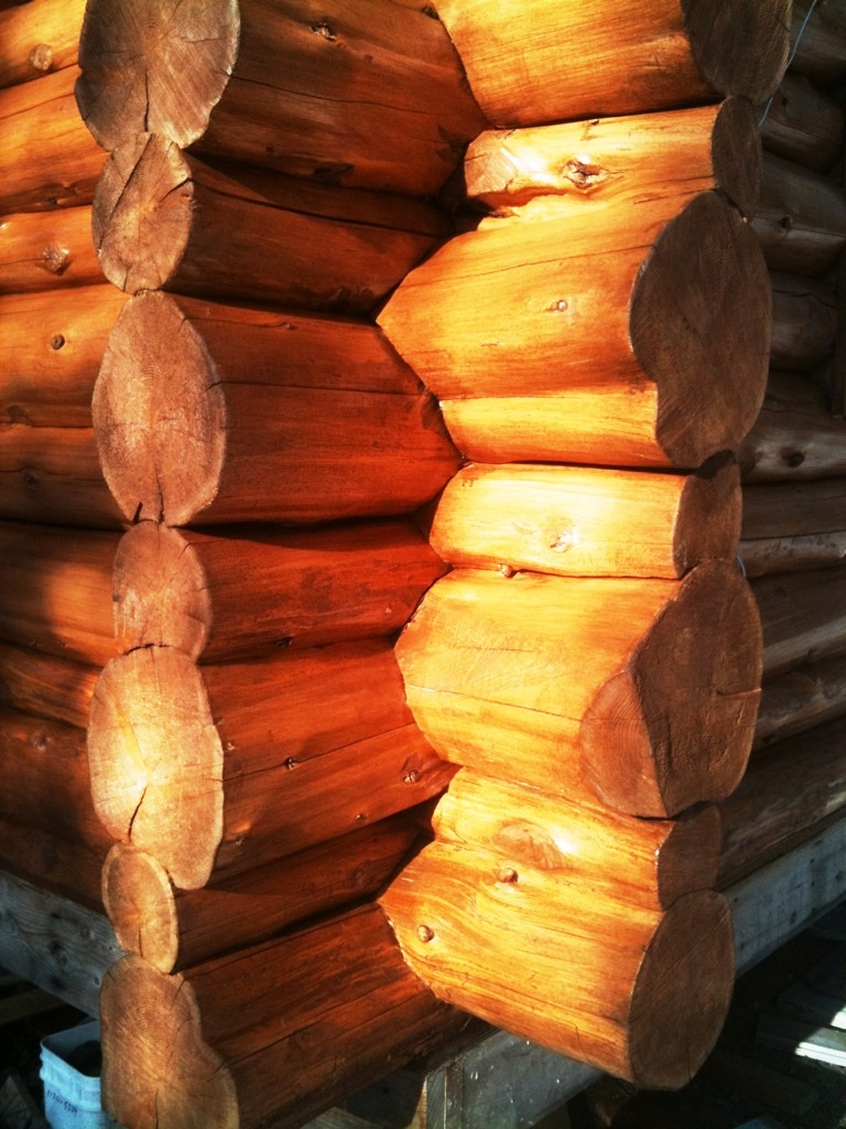

Silverwaterlady I love the color! What color stain is that?
# Posted: 24 Jan 2013 11:38am
I will have to get back to you on that answer as I'm not at home where I keep all my cabin info.
# Posted: 26 Jan 2013 05:47am
1) The logs were cleaned with Log Wash. 2) Stained with Lifeline Ultra-7 in Oak 332. 3) Two coats of clear top coating Lifeline Advance Satin.
