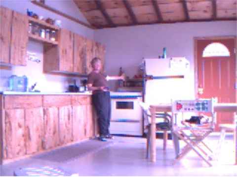

I made these all with 2x4 s , reclaimd hardwood pallits boards and 5\8 x 12 mdf from home depot total cost about 100 $ . tops were 12 '' deep lowers were 24 in deep.i had no plans not much to it. they were 12 ft long with a 12 ft roll top from some salvage yard.there were 3 drawers with store bought glides . removed the nails from the pallets and ran them through a plainer. pic not good only one i have .no longer own the place. Good luck

# Posted: 23 Jan 2013 11:55pm
Thanks for the encouragement, any closer shots of the cabinets or of the framework ?
