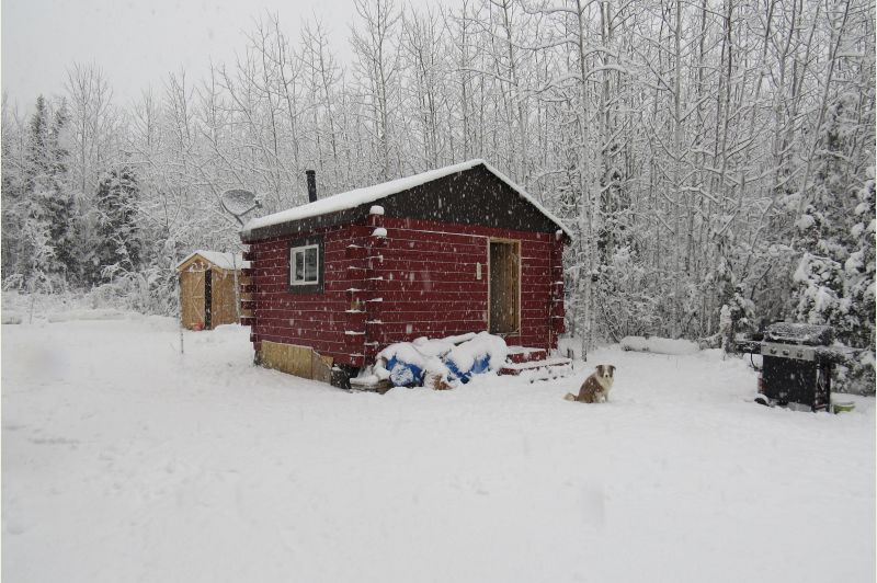

# Posted: 21 Jun 2017 05:47am
All good advice but I would argue a few points.
I built a 10x10 sauna with my wife back in 1980. Some of our friends helped initially when we poured the pad. No cement mixer, no running water. The cement was mixed in big wheel barrows with people carrying buckets of water from the lake.
We forgot to fill inside the homemade forms after tamping so the floor ended up a foot thick. That was a mistake don't do that.
I am going to build one again soon after all this time and I am going to do it the same way except I will take my time and make it a lot nicer, and bigger. I have the time now.
But that whole R value thing irks me. I know what the book says and it is factually correct. Every building code uses the same information and you better comply or you don't get the permit.
I didn't need a permit when I built mine and there were no forums so I bought 2 cases of 12 inch spikes, a sledge, and a chainsaw and built a building with a wall across the middle on the inside separating the sauna and the change room. Lined the sauna with vapor barrier and had a sauna because we needed one! and all the plastic drooped bad. So I nailed scrap lumber all over the place and we used it for that first winter. Then I got some rough cut cedar boards and finished the inside. Needless to say we were broke back then.
That was and still is an amazing building. 38 years and it hasn't changed one bit. The new owner jazzed it up a bit but the structure will be there for a very long time.
We built trusses and put a steep pitch roof that extended about six feet on the front and about 4 foot on the back. We just extended the top timbers out to where we wanted. No real plan.
"eye sweet" I think they call it.
It had about 3 feet of overhang on the sides and the snow just fell off of it.
So we lived in a stick frame cabin and had a solid timber sauna.
What I want to say about R value is;
When we got home from an overnight trip to town which we did about once a month, the stick frame building was frozen. Inside and out.
The sauna was still warm! Two days later....
IMO solid wood is better to live in than stick frame. It might technically be less R value, but it absorbs heat and has huge mass and it loses its heat slower, or it stores more of it or some damn thing. If you live where there is harsh weather solid wood is much friendlier to human comfort. It stays warm.
I have to look hard to find a picture of mine. I will post it when I find it.
I am really happy I found this forum. I am getting ready to build again and look forward to trading ideas and learning some new tricks hopefully before I start in a few months.
Did I mention it was easy? It was easy.
There are some pictures on this site that look a lot like what I built. Different dimensions. I'll find that picture.
