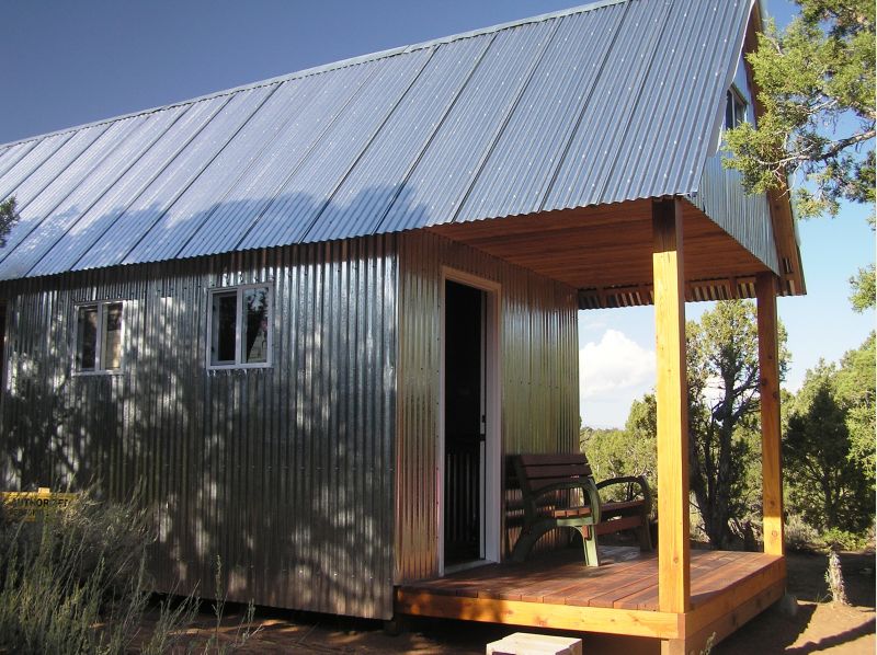

One of my 2 cabins is build entirely out of corigated tin I used a metal/masonry blade that I would cut about 3 panels at a time, (yes it throws tinny peices of metal) plus I used a good pair of hand shears, probablly used the shears more often. Most cuts where accross the corigated which was accually easier that leanthways. Cutting leanthways was a bit harder to cut and to keep straight. I just overlaped instead up cutting leathways to finish the last peices. I used a marker first to make my line. The self tapping screws with rubber washers went in with no problems at all.

# Posted: 12 Jan 2010 01:29am
Cabin
Cabin
Cabin

Great looking cabin Cedar! You need a statue of the tin man out front. Looks fantastic. How does it do with the heat on hot days?

# Posted: 12 Jan 2010 06:58pm
You would'nt believe it but it really stays cool during the summer and it is insulated. I think the sun just bounches off of it. When its in the 90s outside its at least 10-15 deg cooler inside.

Nice cabin alright, How many pair of sun glasses do you own ?

# Posted: 12 Jan 2010 10:39pm - Edited by: Cedar Trip
YES you Guys it might seem bright... but It has really turned out great and maybe one day we will paint it camo, We do joke about that. But No its not that bright and it wont attract lighting either, which I did alot af research on :) . I would do it again, but next time I would invest in a bigger box of BandAids. We figure there wont be much maitenance either and it seems to work out great in the winter and summer. Im still shocked of how cool it keeps in the Hot summer. The smaller windows were a decision we made to make it a bit more secure from break-ins. It will be our sleeping quarters etc. Our other cabin a few feet away will be our kitchen and gathering area, this one has all the windows.
