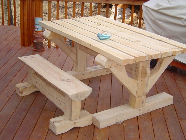

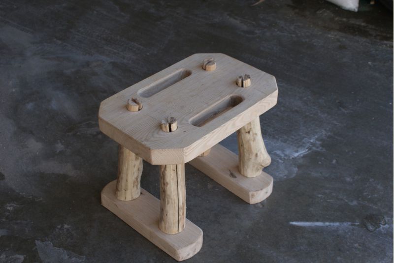

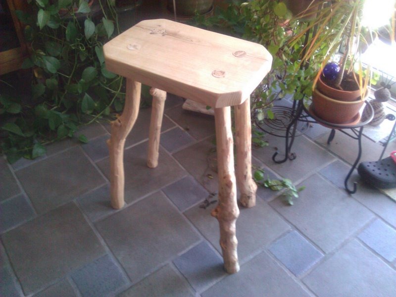

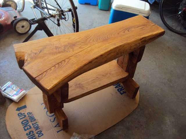

# Posted: 29 Jan 2013 07:57am
A few ideas attached in the photos. I normally work with the wood when it is green. Fine for timber framing. The stool design below uses legs that are attached with a hardwood spline. Since the main portion will dry and shrink after a year I have to sand the piece again as the top of the legs will start to bump up.
If I don't use the wood right away, I put some Anchor seal on the ends to minimize checking. table_1.jpg

I would make sure the wood has a chance to season and dry out before you make any tables. If you leave it in log form attached to the root ball it will stay wet and rot. We lost a lot of good wood, after Isabel because it wasn't cut to log and left on the root ball. Cut it into usable log lengths and let it cure, then your end pruduct shouldn't warp twist or crack. FPW does some fantastic work as you can see by the pictures, get his input for working with harvested wood. I particulry like table_1 and Stool3.
