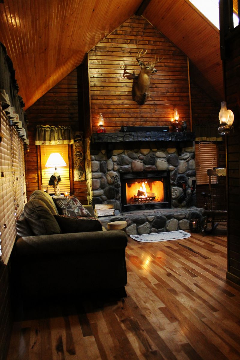

I installed my ceiling using those same boards from Menards right against th paper vapor barrier of insulation stapled to the rafters. I've had no issues at all with it.
