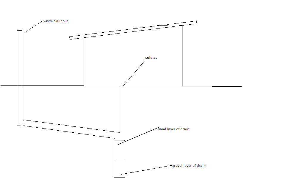

ShabinNo5, I have seen this discussed on another forum. I believe this is what you are talking about http://www.mb-soft.com/solar/intake.html I have thought of a simple system addressing the moisture in the pipe problem. This is a rough illustration of my idea. Nothing is to scale just how it might be able to work. So have fun pick at it and let's see if it can be made to work.
This is my first attempt at attaching a file.

ShabinNo5
# Posted: 9 Feb 2013 07:11am
Reply Quote
exsailor, thanks for the link, I enjoyed the read. Unfortuantely the Shabin is built on bedrock, more blasting than digging.. However your diagram has giving food for thought. The space below the Shabin stays much cooler on hot days.
