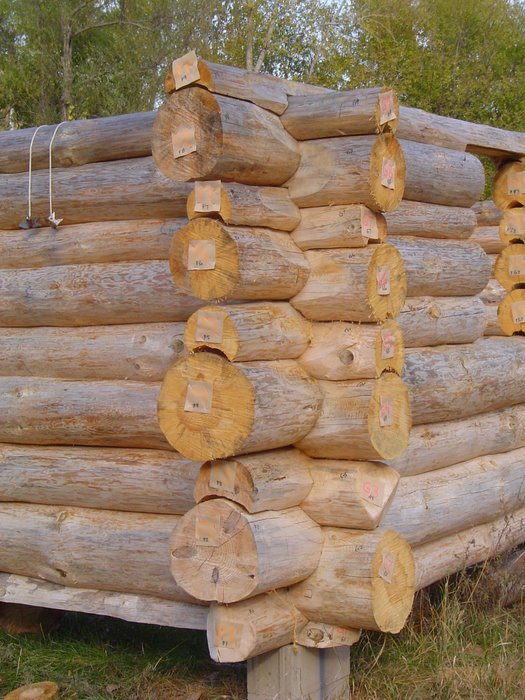

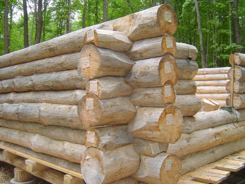

It is not hard. Gotta make sure you mark the logs. In general it goes together only one way. As mentioned above you gotta take her apart.
If you can get a truck to the site, a guy with a decent log grapple, trailer, and just a little talent can disassemble the building and have in on a trailer in half a day.
When you reassemble it make take longer as you will probably need to insulate and such.
It is common practice to build a log cabin in a building yard and then truck it to site.

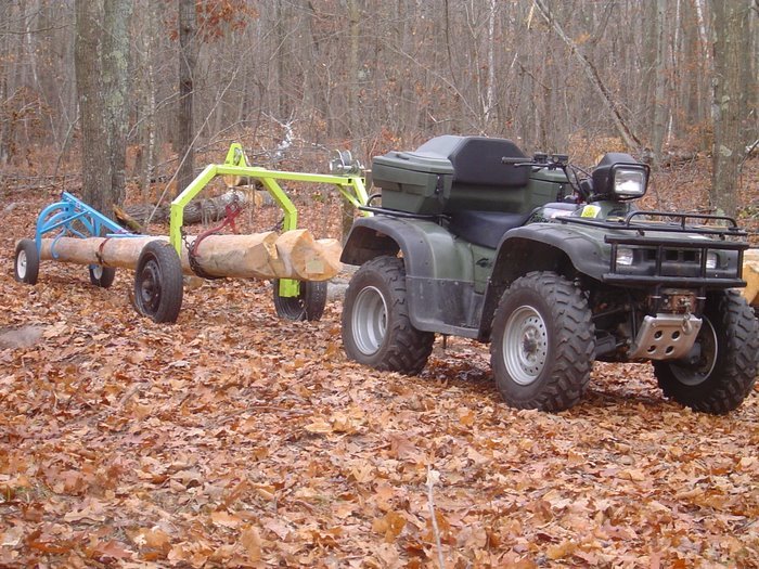

For my log cabin, I built the wall close to home. Then I loaded and hauled them a couple hundred miles to my property. Assembly took a great deal of time because I couldn't get a vehicle to my site. I hauled the logs one at a time with an ATV and then assembled with tractor and gin pole.
When disassemble look at the notches, some may be a lack a little substance on top. In these cases nail on a couple of scab boards to protect the notch.
If you start at this blog link and move forward you can get an idea of how I moved things. http://www.peelinglogs.blogspot.com/2008/10/log-key.html Logs in the building yard
|  Hauling logs with log arch.
|  assembling the building.
