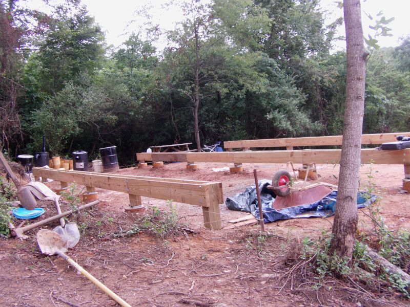

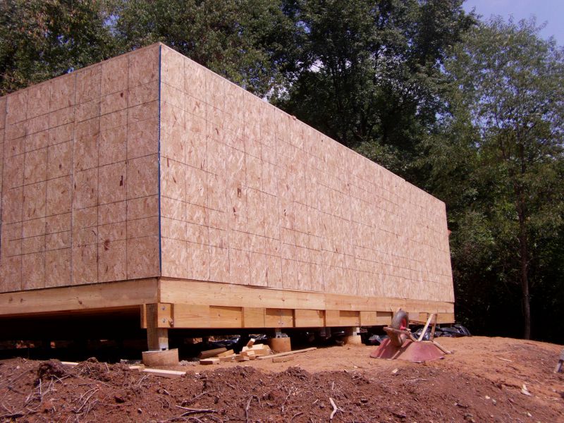

buckeyebuck
# Posted: 2 Mar 2013 10:53am
Here is what we did for the cabin we are building.
