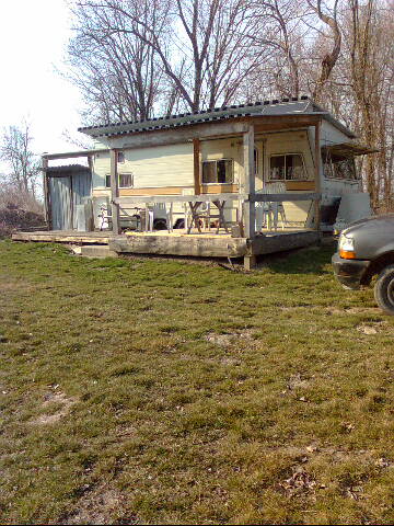

apon revewing a older thread ,I see you are having a prefab deliverd with a dozer .maybe you could cut 2 large logs close by and have him drop the cabin on them [very close to were you want it],My old trailer sits on 2 hardwood logs been there 6 years still leval. all i did was dig out the sod and leval the logs up ,they did settle 4 in. or so the first year and i have reshimed it leval a few tims but its still a foot off the ground high and dry ,IT just might be a temp fix for your delemma . maybe that dozer could work on that road a bit while he is there . I under stand that it would 'not' be ideal but it would get you started.. sometimes getting started is the hardest part ,, best of luck just
