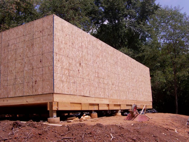

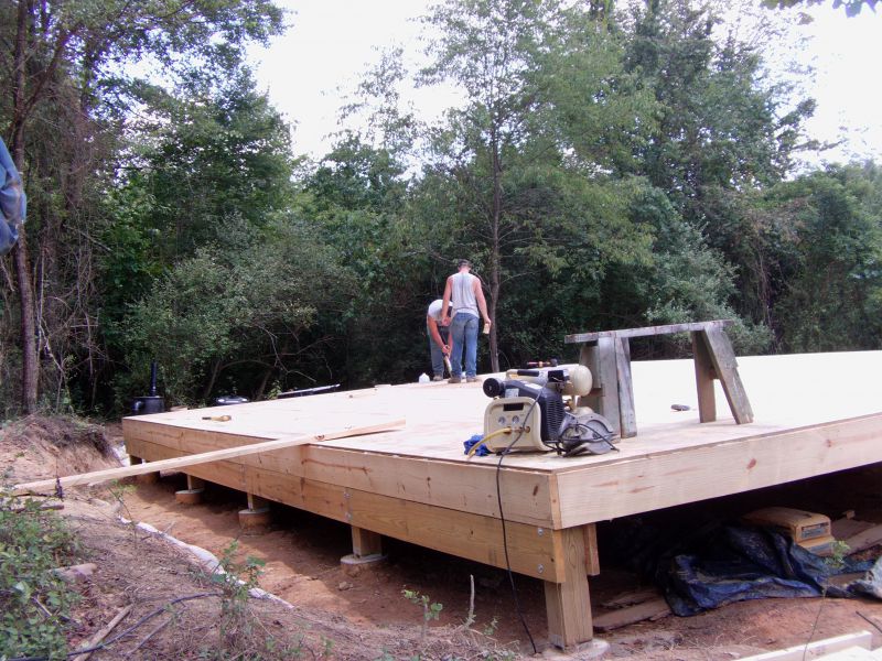

buckeyebuck
# Posted: 3 Mar 2013 10:25am
We used piers of concrete 2 feet into the ground and then 8" by 8" treated lumber with j bolts and bracket to anchor post to piers. Including a pics
# Posted: 3 Mar 2013 05:00pm
I agree with VT.We use this method up here in the north east all the time for a pre built building of this size.It probably has 3- 4x4 pressure treated skid plates under it and 6"floor joists spaced every foot.
