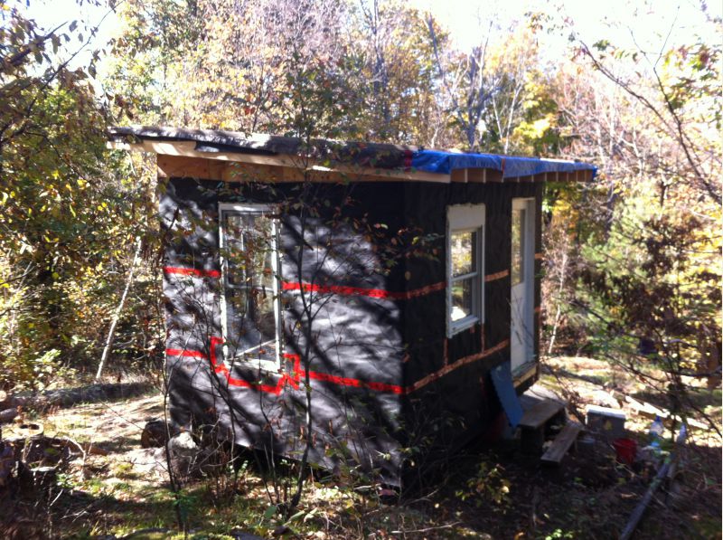

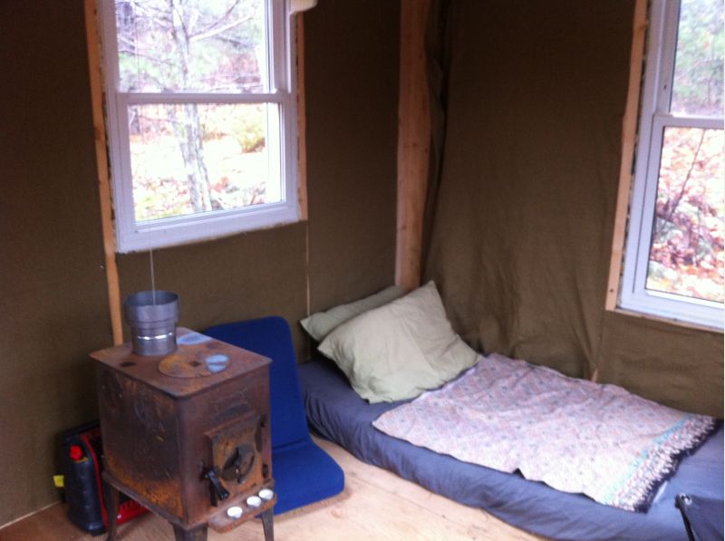

We have a cabin that is 9' x 12' in dimension 8-9' ceiling. We have a old, small wood stove, similar to a wood stove they have/had on a ship. Size of wood stove box is approx. 30" x18" x 24"h.
It has a 4 1/2" sleeve/adapter for a 4 1/2" stove pipe.
NOT a 6" hole, or 8", standard hole.
So, the "idea" is to get a 4 1/2" stove pipe single wall, out to ceiling, or optionally right out to make the chimney pipe too, attach a cap/aerator, and cover with a collar of some sort, or buy a new chimney 6" kit, and use a 6" pipe out of the stove. (Which is safe, but, expensive)
cabin front
cabin front
cabin rear
cabin rear
stove location 2
stove location 2

# Posted: 3 Mar 2013 01:09pm
I would say that, if you can find 4 1/2" pipe, run it from the stove to the ceiling. Transition, at that point, to the 6" chimney pipe. It will be safer than trying to fabricate something as a substitute, and when you replace the stove, it will be a simple matter.

# Posted: 3 Mar 2013 01:56pm
That stove is what is known generically as a "trash burner" style and its what I have. Problem wi th it is you need setbacks. You will find specs will say around 24" from the wall in the back or sides (rear corners) and enough fire proof hearth under it to have about 18" in front of the loading door. With a cabin that small, it would consume lots of space. I know you can add a shield around the back and sides. to be able to get it much closer. Have the shield wrapped around the back/sides and mount it permanently. I know you can reduce clearances by doing this but it needs to be permanently mounted to the stove (by code) not just a u shaped piece setting on the floor around the back of it.
The little marine types for sailboats would be the ticket, but are spendy. I say add shields, just buy the hearth ready made and you should be good to go.
Is it steel or cast iron? If its steel, you could actually shorten it, add the shields. As it is now, its going to run you our of there even on the coldest says.

This is a marine type, schooner, cast iron fire box. called: ULEFOS
It is small enough to fit and heat a small room. It is a perfect unit for this small cabin.
Jotus makes a similar one that can heat a relatively modest size room.
My preference is not to use 6" pipe and a major stove stack and double walled and all. I believe a single wall stove pipe would also make much more sense providing additional heat from it. I do not plan to be making large/full fires in this unit. I will not be loading it up to reach maximum temperature. Far from it.
