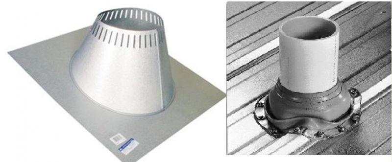

ArkansasCabin
# Posted: 5 Mar 2013 11:26pm
the picture on the left is the 'standard roof flashing' i have, and the picture on the right is similar to the rubber boot i have.

Quoting: ArkansasCabin
I've read that some people install the cone directly below the tin on their roof, and others install the cone from underneath the roof deck
People do a lot of unnecessary and dumb things. This would be one of the more dumb ideas. If water gets past the rubber boot the metal underneath does zilch good. . Just becuz somebody has done it and put pictures on youtube or some website does not mean it was ever a good idea. The rubber or silicone boots that are made for this work when done the way the mfg recommends. Save your time and don't try to reinvent things when the boots work. Just follow directions and take care forming it to the roof panel. Easiest to install after the roofing is on, drill a hole from the bottom to mark the center or fire a round through the roof if you're accurate and in the boonies and then cut out.
Martian
# Posted: 6 Mar 2013 08:19am
If your chimney comes out close enough to the ridge, and you can tuck the upper edge of the flashing under the ridge cap, then it will work fine. But, if you are in the middle of the roof, use the rubber boot.
# Posted: 6 Mar 2013 10:35am
Use the metal flashing made for molding to the shape of the roof metal ridges. Its flexible for just this reason. Its sealed and screwed down. Then the drip collar just above it on the chimney itself. Rubber might be fine for small drain vent stacks.
Martian
# Posted: 6 Mar 2013 07:27pm
They make special rubber boots for a chimney. They work really well.

Paul
# Posted: 9 Mar 2013 01:16am
use a metal flashing and seam it above the pipe if you want a permanent seal. the rubber boot is a compression seal and really isnt meant to be used without being screwed down to something solid under the panel. Maybe you can frame in a box using metal studs but i know nothing about material clearance involving framing and wood stoves. Most panel manufactures make boots to fit the profile of their panels somewhat or if the profile isnt too high you can use a standard one and bend it yourself. I know it sounds counterintuitive to say seam a metal roof but a proper done lap seal above a pipe is leak proof.
