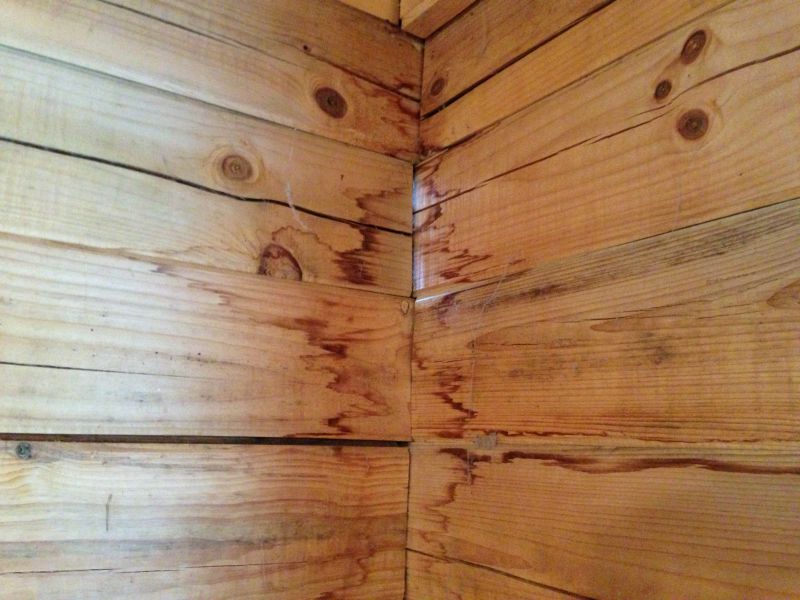

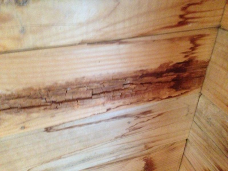

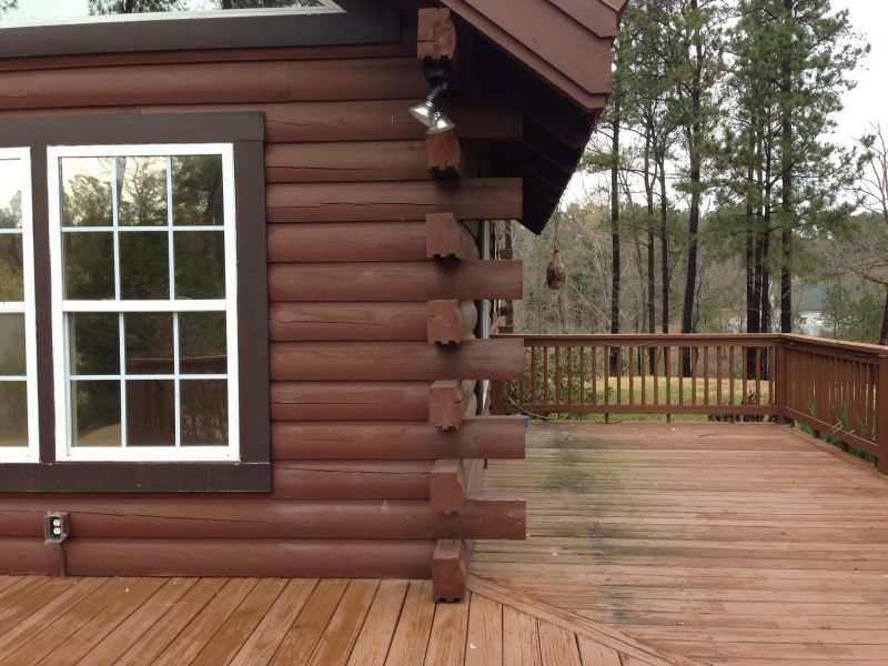

Never owned a log home, need to know how serious this cracking and water damage looks. I can see daylight and water stains in the corners, large open cracks inside and out (see pics) this is a foreclosure vacation home I am considering buying.

I just did log replacement and repairs last year..these logs look to be in excellent condition..you can you a small hunting knife and shove it in the cracks where it looks soft or rotted. If it goes in more than say 3 inches then I would suggest log replacement..which on yours doesn't look like it would...and your logs are not locked together just butted up which makes replacement easier..that rot in the last picture can be dug out and use ewood and mbalm to repair...the light showing through is probably just some shrinkage..use energy seal and seal up all the joints to keep water out...use permachink products their the best..there website shows you how to use the stuff too..anymore questions just ask

Ohh and the only major concern I see is that deck up against the logs...is it properly flashed on the header board? Proper eavestrough is a must ..water bouncing off that deck will rot the bottom logs in a short time..will dirt and leaves ect get stuck between the deck plate and the log...it's good to have a space where stuff can fall through and you can stain that bottom log properly and keep it dry

old log cabins had used a mud based chinking and had large overhanging roofs thsat protected the water soluable chinking from rain. even on newer style log cabins an over hanging roof protects the logs. the log cabin kits i have seen were built by people who think in terms of modern construction (not old time cabin knowhow) and usually end the roof with only a couple inches extending past the wall, a practical money saving measure on vinal siding or wood siding but not a practical feature on log cabins (that siding reprells water on its own, logs do not).

I agree with davey25 that the logs appear to be in very good to excellent condition. The picture on the right appears to show a large rotted section. However I believe that the large patch has been there since the building was constructed. The water marks are only near the corner of the building. If you decide to purchase I would focus on sealing from the outside. While the water damage is currently minor. The fact that water marks are visible suggests that the end grain of the corner logs are absorbing moisture. Structurally the cracking is not a problem.

Water can be blowing at those corners during storms, maybe its a seldom event. Maybe all you have to do is seal the cracks. You may be able to "wash" off some of that discoloration with a careful application of bleach? And that rot... I'd just seal off the cracks on the outside, and then try to stabilize it. It doesn't look that bad. There are some chemicals you can use that absorb or inject into rotted wood and firm it up, then you could fill it and sand it. Try asking a log cabin products company like..... cant think of it, but just search "log cabin products".
