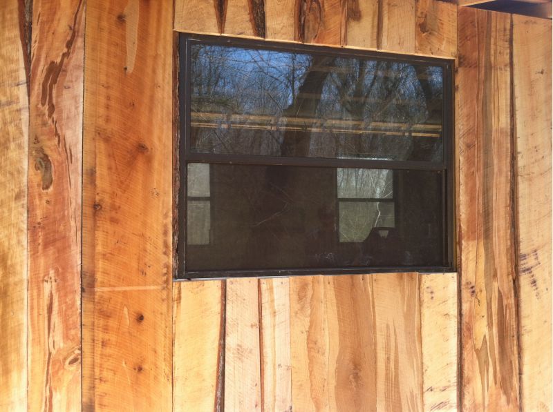

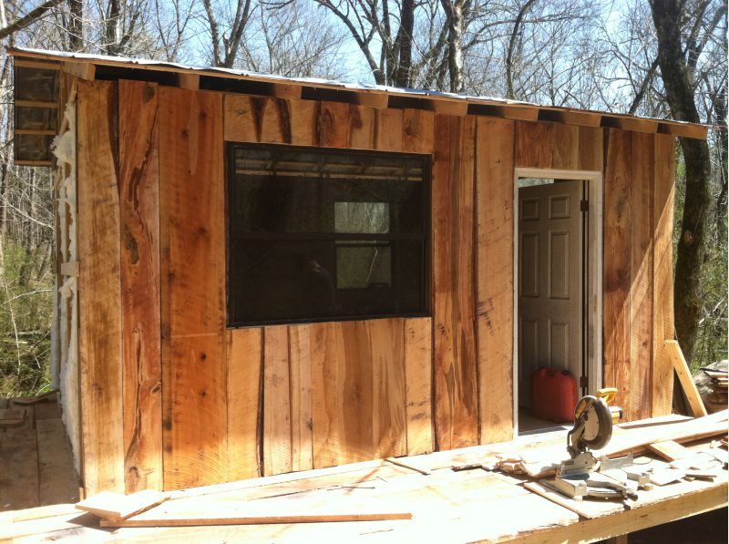

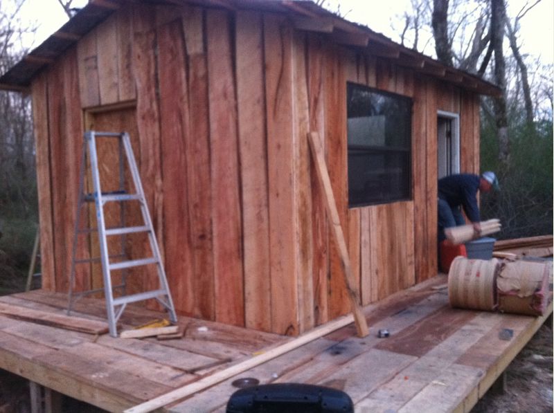

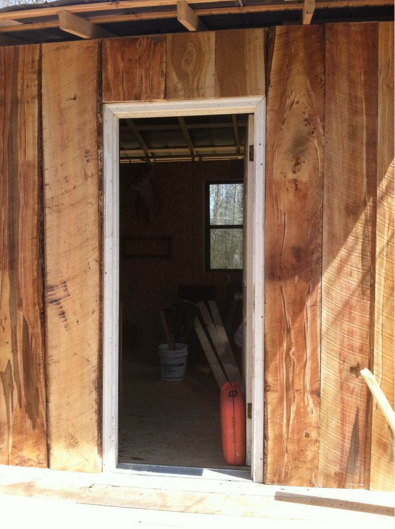

This siding isn't done yet or coated with anything but I got this from a local sawmill. He called them rine boards and they are typically about 1"- 1 1/8" thick and anywhere from 6 inches wide to about 15 inches wide. They are all about 8'9"- 9' long. They are very sturdy boards and I love the look. I paid 180 dollars for a bundle of 100 boards.

rlewi09: do you put a tongue and groove on the boards? If not how do you seal the seem? Who puts the straight edge on?

I am going to put the battens on in about a month so it will be board and batten siding. I am also going to put a coat of clear wood sealer on it too. I wanted to just put on T1-11 but this was well worth it and was about 1/4 of the price of T1-11 or hardi.

I love the look of b&b, but not so crazy about all of the gaps. I've considered T-111 with cosmetic battens nailed over.
rlew09, I'm with you: I like the way that looks. It's subjective, of course, but to my eyes, it looks like a cabin is supposed to look. Carry on.
# Posted: 3 Apr 2013 10:06pm
if you wanted to do it rlewi09's way, you could set the boards in a base of something (silicone, thinset) and let the water run down the vertical cracks......
