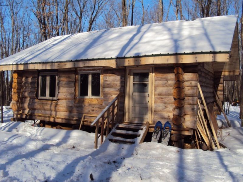

# Posted: 19 Apr 2013 12:51pm
Quoting: fpw
like holes and sack-crete. Holds up; not high tech. Easy. Cept the digging part.
Damn nice looking place
