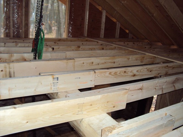

I did mine by posting to beams and canterleaving out.

Loft Flooring Going In

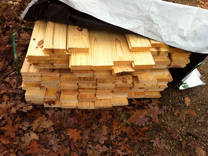

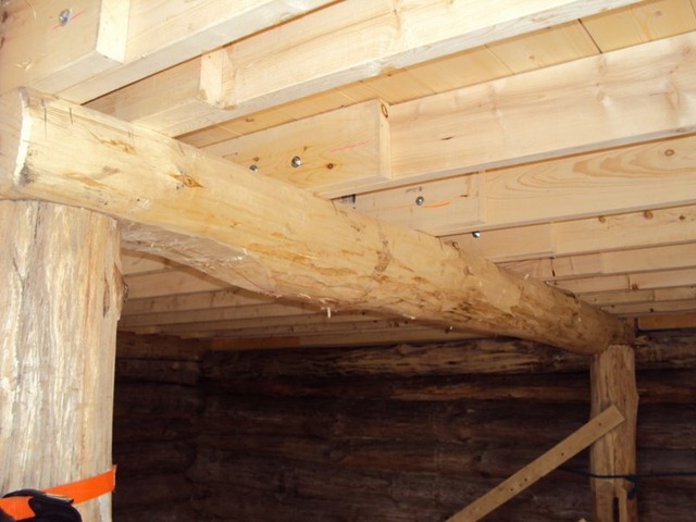

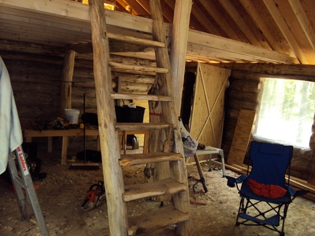

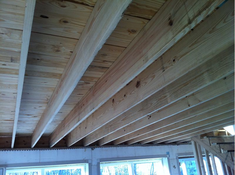

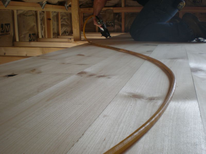

We used 2x6 t&g southern yellow pine. I wanted dug fir, but couldn't get it in our area.
For the price it wasn't more than using t&g sub floor and then something else on top and on the ceiling below.
Delivery
Delivery
Under side
Under side

before clear coat
before clear coat

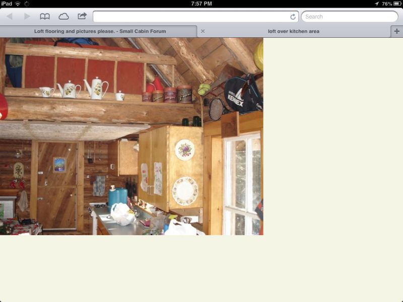

The flooring above the loft is pine planking which is covered with carpet. Under the loft is a tin ceiling. The tin was salvaged from the ceiling of an old house and we used it in the cabin. The tin is in 2x2' squares and fastened to wood strips. It's quite rustic and fits the look of our rustic log cabin and helps brighten the kitchen area.

skootamattaschmidty
# Posted: 8 Apr 2013 09:31am
The carpet really helped with the sound. I also like stepping on the carpet on a cold winter morning rather then cold wood. We didn't have nice flooring down beneath it though that was covered up. Just 1x4 planks. The tin helps brighten up the kitchen and since it was antique it fit in very well with the rustic nature of our cabin. The tin ceiling also helps to keep stuff from falling on the table below.

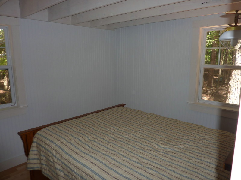

beachman
# Posted: 8 Apr 2013 06:10pm

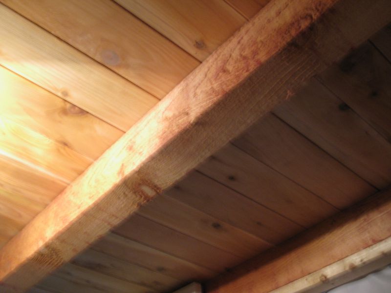

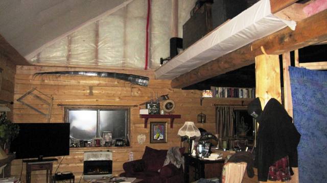

Purplerules - the underside of your loft looks very nice and the wood is beautiful. You might not want to do anything but stain it and verathane it. I am sending a shot of our place where we white-washed the underside of the loft with a white base coat just to brighten up the room.
bedroom ceiling to loft above
Purplerules
# Posted: 9 Apr 2013 11:38pm
Beachman - That really looks nice and was a great idea to lighten up the room.

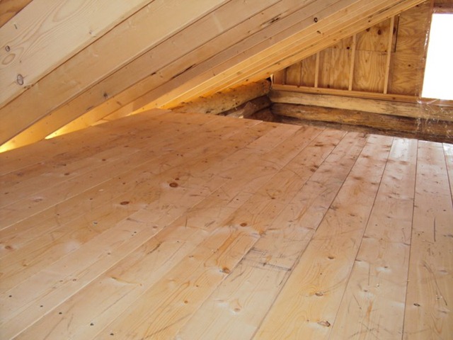

fpw

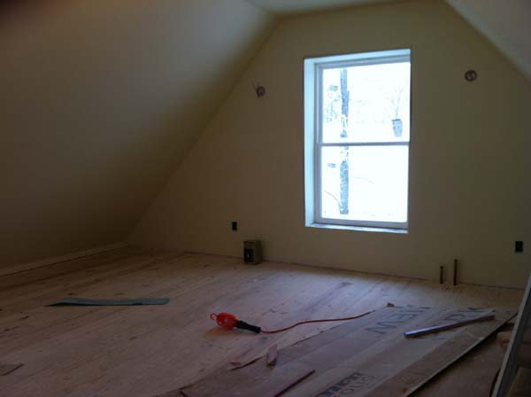

# Posted: 16 Apr 2013 08:22am - Edited by: fpw
Flooring 1" pine boards

This is how we went. Rough cedar beams with smooth cedar decking.
