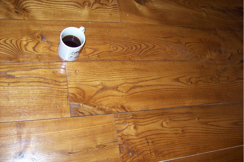

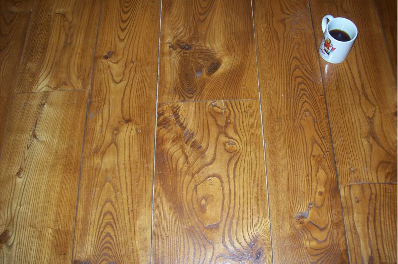

the pic is of a ash floor in our home . we wanted a wide plank floor rather she wanted --anyhow ,cut the wood from our bush 12 '' 10 '' 8 '' 6 '' in boards drilled , screwed and pegged to the ply subfloor .
tryed to sand it with a hand belt sander but it took to long and did not look good ,i then rented a large stand behind orbit sander , for one day and was very happy with it .lots of knots and chips but thats the beauty part we were after .she was write as usual,, I then stained it and did 2 coats of poly,, good luck
