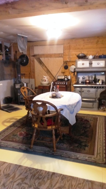

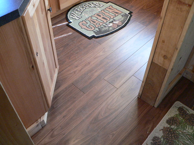

# Posted: 17 Apr 2013 08:28pm
I liked the idea it didnt glue or have to be nailed. No special prep to the floor itself, no subfloor etc.
