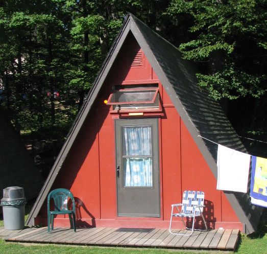

I talked to a guy who had stayed in this cabin and took the pic
and he said the full loft used 2x4s as joists covered with plywood
and there was a wall in the middle of the A-Frame with a door in it
making it a two room lower level space. He also said the
head space on the main level was only 6ft 6 in from the floor
to the bottom of the loft joists. ( not much waste there unless
you are a midget ) He did not remember whether the main
A-Frame rafters were 2x4 or 2x6 but I think my desire for insulation
will probably rule there. On one side of the cabin I am thinking of
creating a knee wall full length behind which will be a lot of space for storage.
I'd just like to know if anyone knows of any other similar AFRAME
structures that I could study for ideas etc.
Would of course appreciate any suggestions etc.
Thanks
Nirky

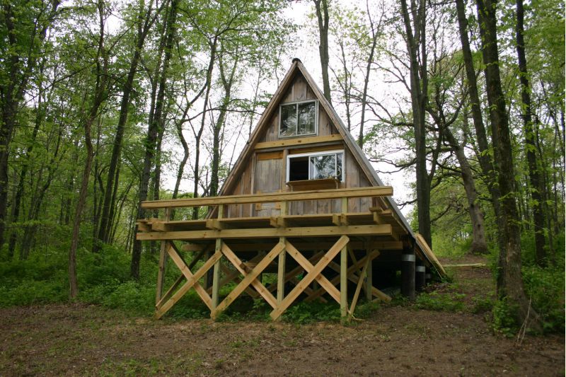

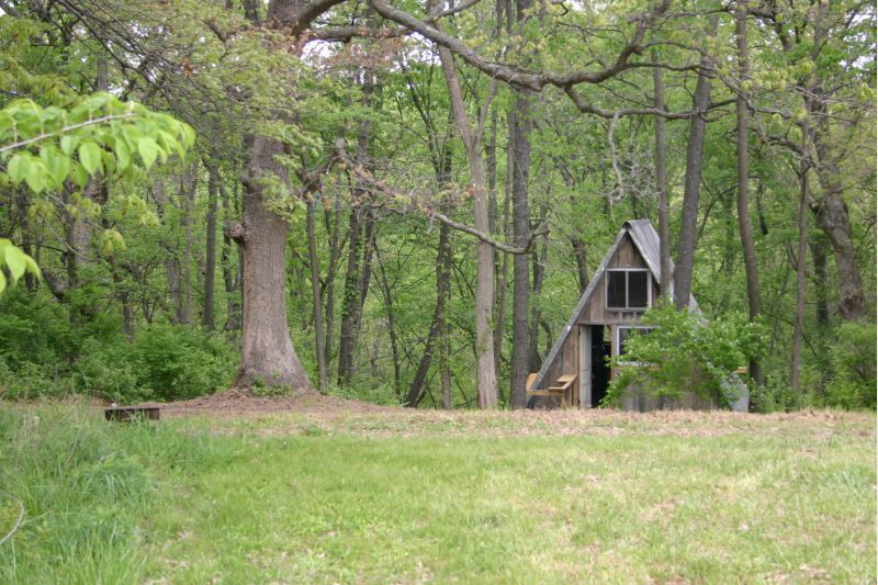

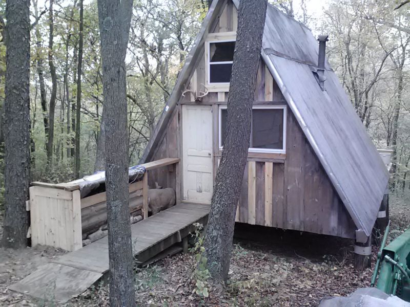

Here are a couple from my back yard and a shot or two before reroofing. I hope you like them as much as I do.

The roof in your 1st photo is a bit perplexing as it appears to be solid
sheet metal but you did say shots before reroofing. What are you using
on your roof? Would also appreciate seeing some inside pics of your
ladder, loft area and loft joists etc.
It looks like you could have a whole lot of covered storage under
your deck as well.
Thanks for sharing.

I am at a quandary, the sheeting you see is stainless with a seal coat. I prefer the look of shingles and have marching orders from the wife to go ahead. I just do not yet have myself convinced that replacing that stainless sheeting is the best idea. I also like the sound of rain on tin.
I will get some of the inside for the forum, there are some of previous work somewhere. I should in the next few days go out and get ready for spring and I'll try to get some current ones while out there.
The loft is split in the middle with the stove pipe, ladder access and storage/guest room over the main entry. The main room is obviously over the deck entry and can be completely isolated from the rest of the interior allowing the ability to heat just the 7x7x7 triangle room. Very convenient in the winter hunting months when you do not want to start a fire wile hunting. A small burner for the coffee pot keeps the room at a very comfy 55 to 60 with the window cracked. Shorts and a rifle @5 below is quite a treat! Above freezing and two bodies keep the small room plenty warm without an added heat source.
The downstairs is 16 wide x 18 long open floor plan with the loft joists at 7 ft. The front is 3 ft off and the rear is 7 ft off the ground on telephone poles as stilts. Main beams are true 8x8 timber beams set into pockets in the poles. The floor joist are of 2 1/2 by 12 1/2 rough (actual dimensions) barn timbers and the floor is 1x14 planks. Loft joists are 2 1/2 x 8 1/2 rough sawn as well. The walls are unfortunately 2x4 but real 2x4, affording to option of r13 insul rather than the r9 or r11 that fits the tiny 2x4's of today. The roof/wall pitch is nearly dead on 60 degrees, skip sheeting style with 18 ga stainless corrugated sheets. The skip sheeting also helps with ventilation between the outside and the insul giving just an inch of air between the insul and the exterior sheeting. If The roof does get replaced i will vapor barrier at that time. The insulation is kraft papered so there is a vapor barrier on the interior. The peak is at or very near 16'. R13 insulation and dog eared fence pickets keep the walls warm and not itchy. The upstairs main room is scheduled for t and g cedar but it is so cozy now I am in no hurry. The wife will prevail I am sure but not this season hehe.
We employ two Duracell 600 battery packs and two 30 watt solar panels for power. Plenty to charge any device for a week or two and enough to keep the drills charged for that occasional upgrade or modification. with built in inverters and charge controllers they are really the way to go if you have a light seasonal power requirement. If you haven't seen the Duracell power packs it is worth taking a look. Completely portable ac power for 500 bucks inclusive. The stove is a 1920 era wood burner from a local tavern that has since been shut down. The tavern was started in the late 1890's and hold a bit of local history if nothing else. Sorta neat anyway LOL. It sits on a sheet of 16 ga steel and has 6 ft wide corrugated steel siding from floor to ceiling and above for radiation and heat protection for the wood. (no wood closer than 24 inches for that extra peace of mind.) The buck over the door weighed 326 pounds and was taken less than 20 feet from the front door!.
The fishing hole is 300 yards away. A nice little walk for a morning of catching or swimming for the kids and within earshot for the parents sanity lol.
