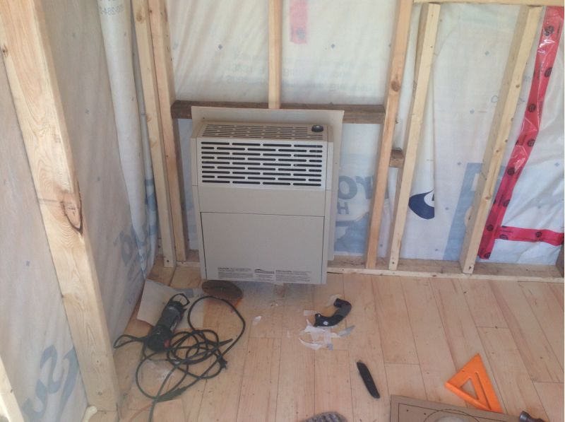

mojo43
# Posted: 22 Apr 2013 07:11am
Here is the furnace installed
KSalzwedel
# Posted: 25 Apr 2013 01:58am
Looks good mojo
mojo43
# Posted: 25 Apr 2013 08:11am
Thanks, I still have a lot to do!
