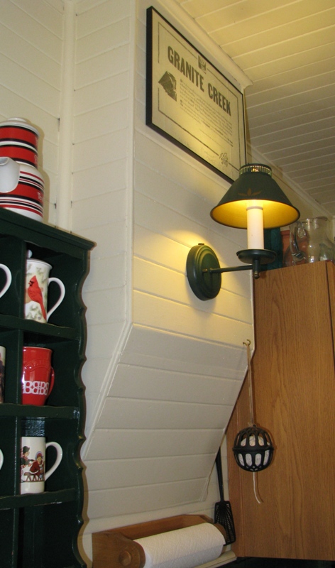

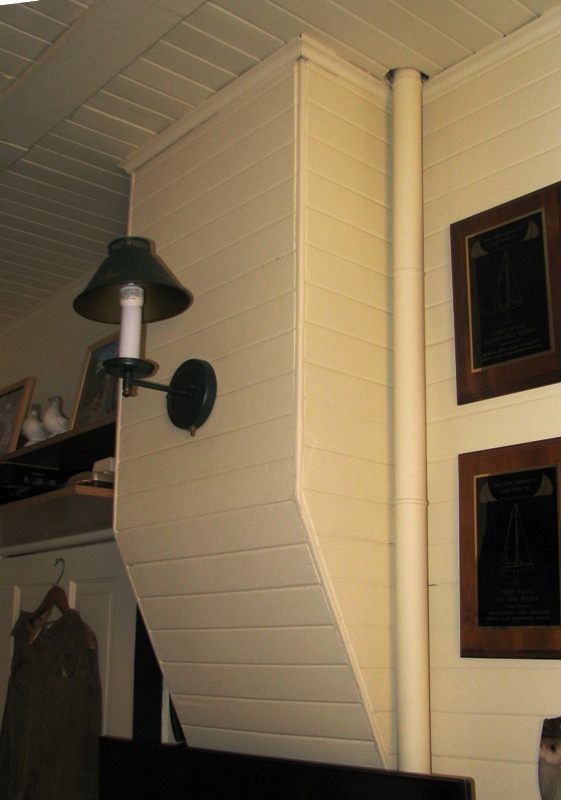

# Posted: 23 Apr 2013 11:48am
  Our house/cabin was built in 1912.  It was originally just two rooms and there was only one chimney.  The chimney had an opening to each room, so there was a stove on both sides of the wall.  The chimney isn't used anymore, but we have kept the half chimneys and put a light fixture where the stove pipes used to come out.  The bricks only went down half of the chimney and then the wall supported the rest of it.
  Below are pictures of both sides of the wall.  Where the lights are is where the old stove pipes came out.
