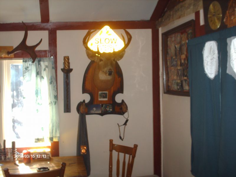

# Posted: 2 May 2013 10:22am
i done this at my camp. just got the one pic though. Hope this helps
manny
# Posted: 2 May 2013 10:24am - Edited by: manny
this is the only pic i could find. I think the strips were 3x 1/2"

Thanks manny! I can share this idea better with my wife with photos!
