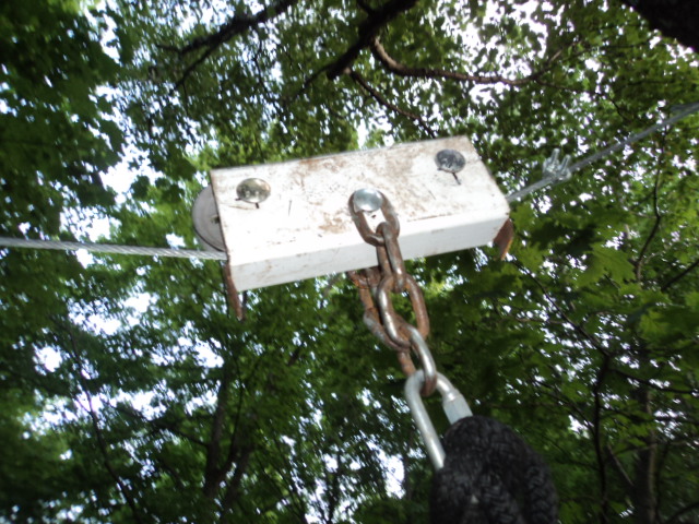

I built one last summer for the grandkids. I used 3/8'' x 200' to big trees. I used two ratchet straps to tighten the cable, first one than the other. I was surprised how much effort it was to get the cable tight enough to hold 120 lbs. Then I had trouble with pulleys. I used garage door hardware. That pulley started to spread in the first day, so then I made a trolley with two pulleys, that seems to be working fine. It took a couple of days to build. I could have carried a lot of lumber up a pile of rocks in that length of time.
