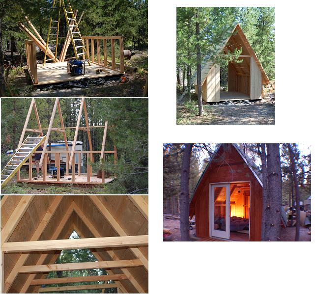

Hi Rick
We built our 10 x 12 in that style.
But then again, 10 x 12 is rather forgiving as opposed to a 16 x 16....
