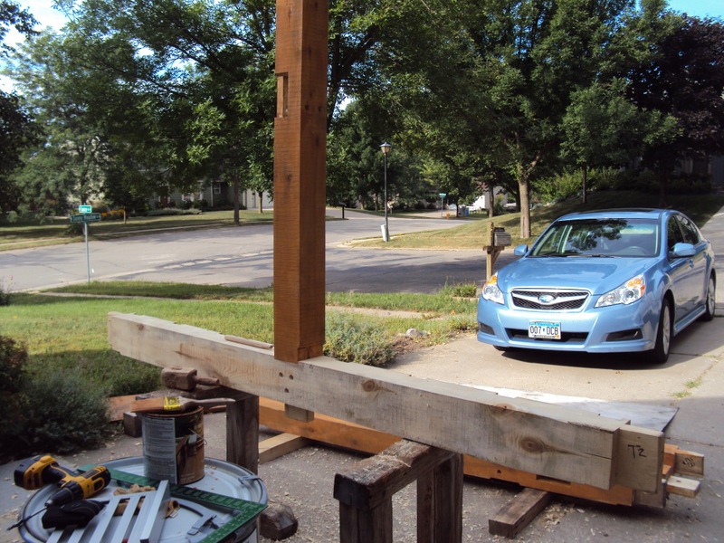

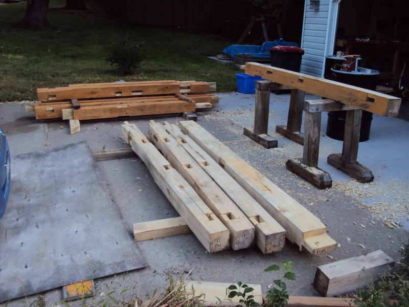

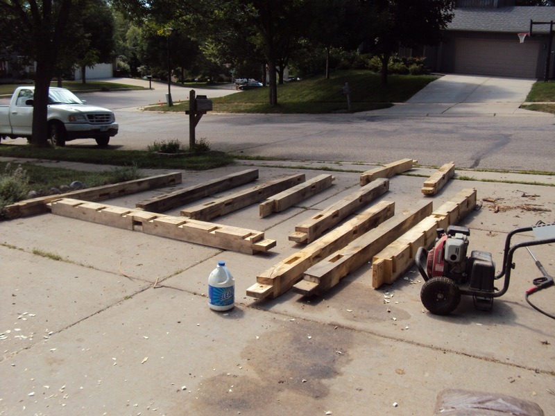

These beams are Aspen cut in late spring. So they turn black very quick. I soaked them with bleach, used a pressure washer, and then applied stain. They went from quite black to acceptable in a short time. DSC034024.jpg

Quoting: fpw I soaked them with bleach, used a pressure washer, and then applied stain. They went from quite black to acceptable in a short time.
Like I said... (and the old time farmers) that works perfect every time.
