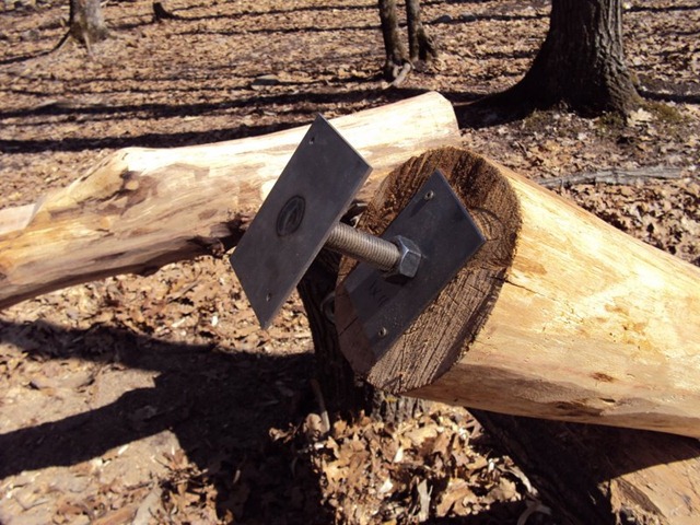

Screw Jacks can be used for posts. A building can sit on them if you like. Just check the building load and make sure the jack is rated for the size of the building and the number of posts.
Here is a link:
http://www.loghelp.com/p-1831-screw-jacks.aspx
Or, you could have some welded up with plate steel and all thread.
Screw Jacks
Screw Jacks
Installed in a post
Installed in a post
