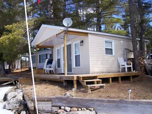

The cabin I am looking at is only 3/4 years old and looks really well built from the pics. 16X18 plus a 4 foot front porch, so roughly the size of your cabin originally...Double hung windows, patio door, tin roof, insulated for four seasons, propane fridge and stove and water heater, wood stove, good cupboards etc etc...for what I think is a really good price. I don't think I could build it from scratch for the price.
My concern is with the moving. It is pretty close by to me, (5 miles maybe)... how do people move these entire buildings without wrecking them? If I put in some posts, or blocks?...how would the cabin get placed on top of it without damaging it?
I am going to see it this weekend. Does anyone have any tips on what to look out for?

appreciating all the replys...! lots to think about. The seller said he scoped out the route, and there are 2 o/h wires to deal with...he said we could just shove them up out of the way with a 2X4...!?
I was pricing what it might cost to build from scratch, and it boils down to labour in my case. The materials would cost roughly what he wants for the cabin, so I would be saving labour costs...in my situation, as mentioned upthread, I suck at building so I would have to pay someone...
I am still quite interested in getting the cabin, but I will need to see if the seller is interested in helping getting it moved and set up....if he isn't, I might be out of luck...
here is a picture of the cabin in question...obviously the side deck would come off...I thought I could someday screen in the front porch. I think it is a pretty nice one room cabin...any more advice before I go see it?
